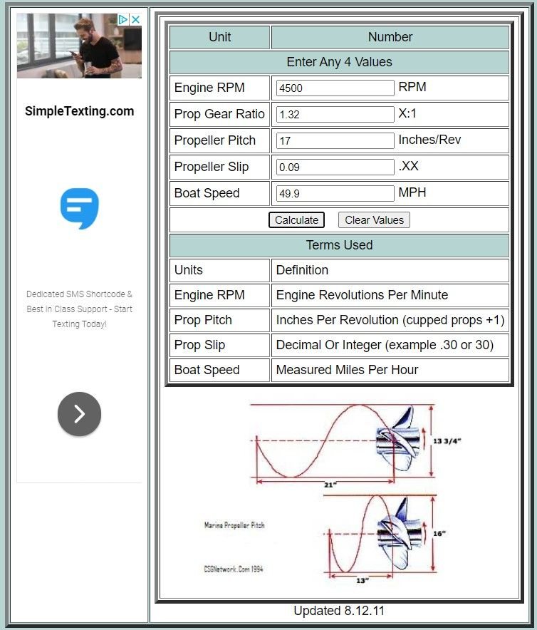

Ok back from testing. Well testing one prop. Had some other issues with fuel today so I need to sort that out. Anyways I had the 17p Mirage plus mounted up so ran that first. Did like you said and got the boat up to about 25-28 then played with the trim. I could feel it ease up and hear the change in the motor so I think I had it on plane correctly. Then I eased into wot. Managed to get 49-50mph at 4500rpm. Might of had a little left but ran out of smooth water and had to turn. Was able to achieve those numbers twice with the 17p. My issues with fuel started after I changed to the 21p so I never got to run that again to get new numbers. According to BBlades prop slip calculator I’m at 8.89% slip so that is closer to what it should be?

Sounds like you are right there or damned close! I think that 17p is what is going to do it for you. I agree with your slip numbers:
