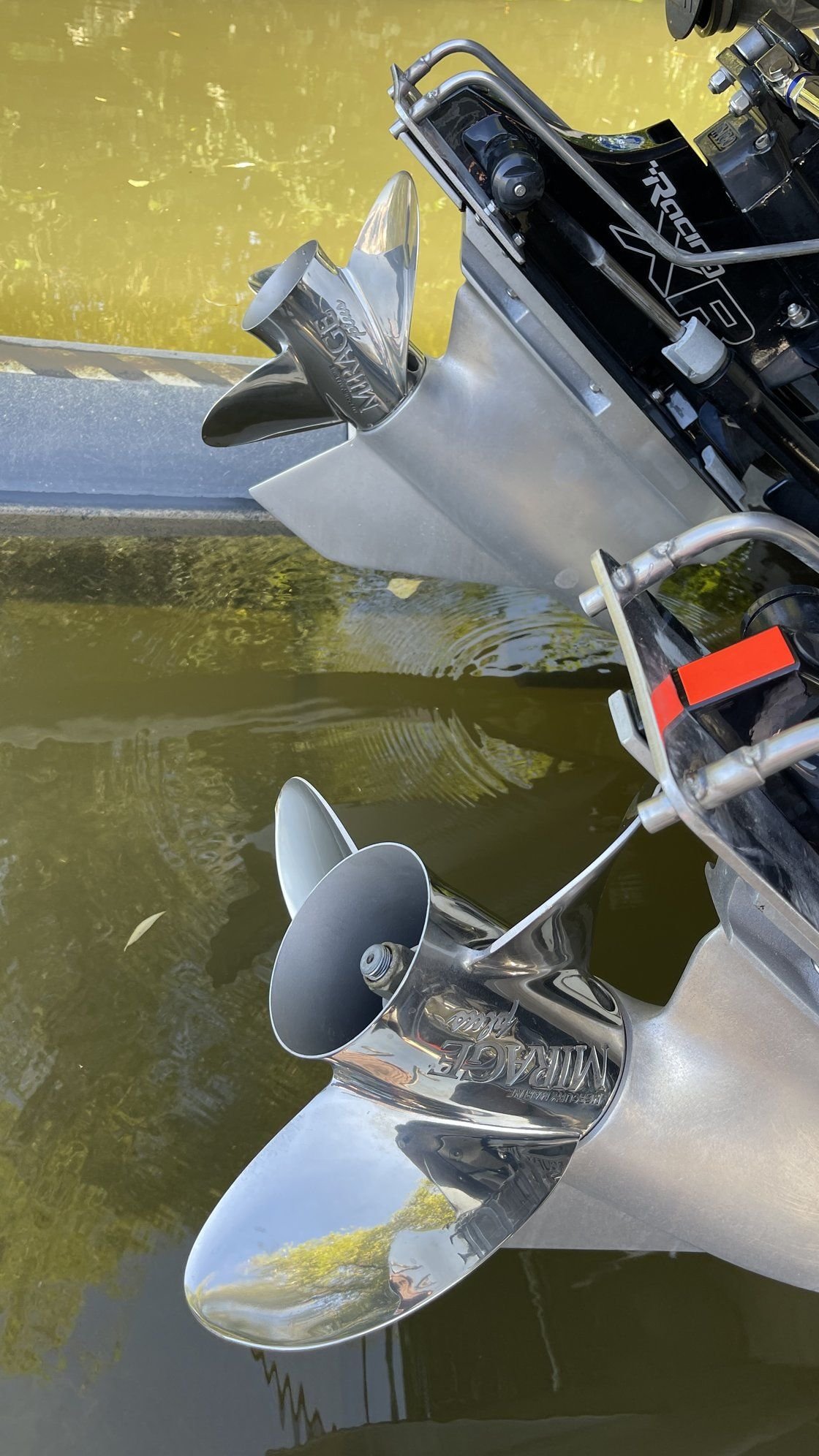

The Mirage Plus are on the boat and it came not in plane ??
Any idea ?

Did the drive shower bring the air to the prop ? Tape the holes ??
Should i tape the exhaust inlet ? Front and side ?
I will test it ?? No other ideas at time.

Did you try putting it in gear and giving it a lot of throttle then pulling back on throttle and then catching the wave and giving throttle again ?. The wave will sometimes give enough lift to get you on plane. only other option I can see is a 1 or 2 inch spacer on the drives. Also it looks like those props have the removable ventilation tabs. Black plastic on the side of the hubs. Try removing them.

Blueabyss Starting with the second wave working with my Lab Bravos with the welding on tube. With this 3 Blades I don’t came in plane.
The 3 Blade Mirage are not lab.
If I open the vent holes, is it not than more air and faster blowing out the props ???
I have testet today:
Close the Drive shower holes and the Exhaust hole inlet with tape.
No way to get the boat to plane.

I changed to the shorty’s with my 502efi setup and the boat was a little bit slower ( because with many trim the torpedo goes down, now I’m faster and need less trim, more straight) but better in handling. No jumping, more straight thrust, no wiping. Since this shortys i can’t not go in plane with 3 blade props. With Standard the 3 blades have no problem. Now I run with new motors faster and the shortys are great in handling. I have new lower XR with 0 hour but I don’t now if it is useful with mirage ??

Your picture "A"
Your picture "A" zoomed in.
Your picture "B"
Yoir picture "B" zoomed in.
These last 2 pictures for camparison, from blue line up to cavitation plate.
Zoomed in, this drive is raised 3 3/8 inches. The blue line is runs down the keel of the boat.
my opinion is not that your prop shaft is raised 2 inches, but the difference in shape of the lower unit from the blue line up between the two different lowers. Stock and minus 2
I tried to zoom your pictures in on the end of the lower where it is wide and shaped like an i beam.
that section all the way to the leading edge of the lower is causing you to blow out and not get on plane.
(my opinion)
This is bad news that you couldn't get on plane, those mirage plus are good props.
Do you still have the stock lowers ?
It would be interesting to know your propellor shaft height.
edit in; it wouldn't hurt to try spinning the propellors out, it may not work, but it's a free test.

Thats old pictures with and without -2".
I will check today the x-dimension.
