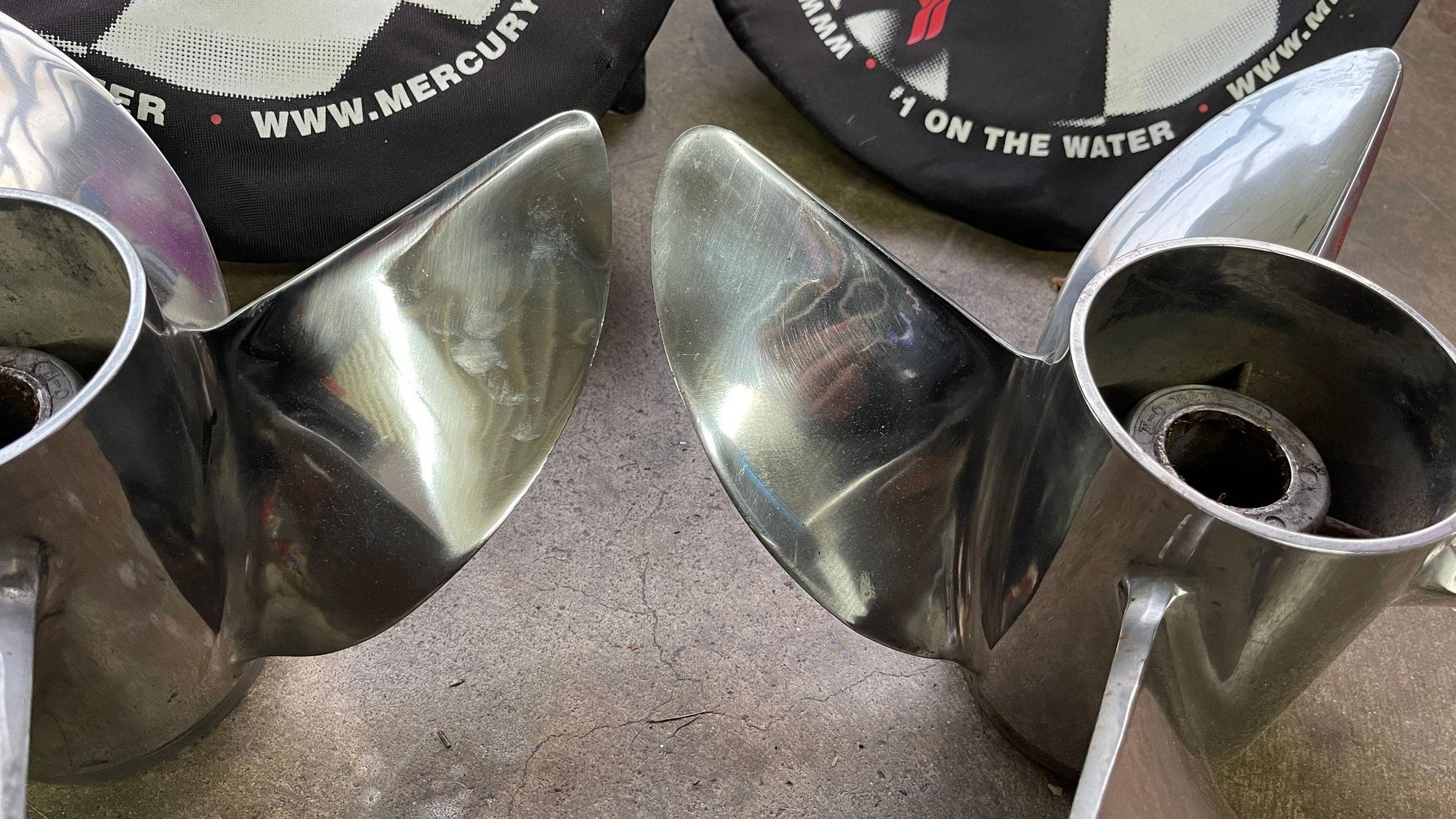

Hello I bought a used triple prop set.
Hydromotive
2x HC-CL29R
1x HC-CL29L
the RH props have the same blade shape, but the LH are different.
They have matching Numbers but different blades ??? Different years ? Ore what is wrong?
I will use only 1x RH and the 1x LH on a twin setup. Does it work ?
Someone selling a HC-CL29L with the blade shape from my RH props ??

Both props have the same numbers on it. only L and R are diffrent. The RH are more like a cleaver than the LH with the round ears. Are the RH reworked ? Why are the LH not match the RH in the optic ? Are the diffrent ore can i use both together ?

I'd say one of them has been reworked, but I don't know which one.
I'd run them and see if you notice any difference.
