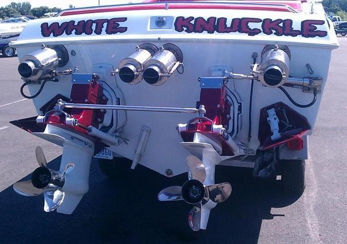

to stop the confusion, take a pic of the back of the boat and post it That will help confirm the rotation ,

https://cimg6.ibsrv.net/gimg/www.off...c98d4659ec.jpg
Confirming port LH-CCW / stbd RH-CW

Spinning out LH-RH
https://cimg8.ibsrv.net/gimg/www.off...6f31baa7cb.jpg
