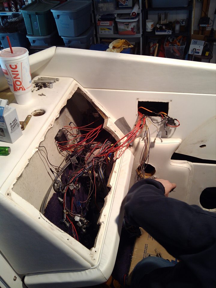

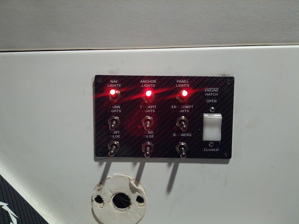

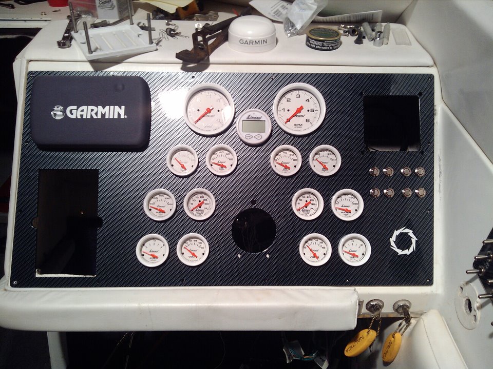

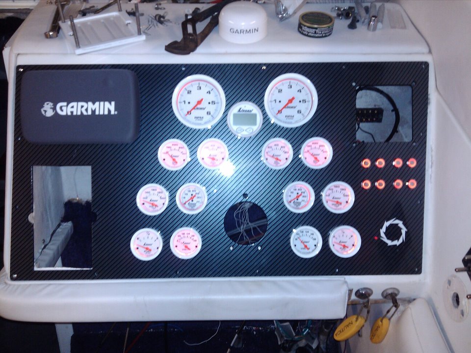

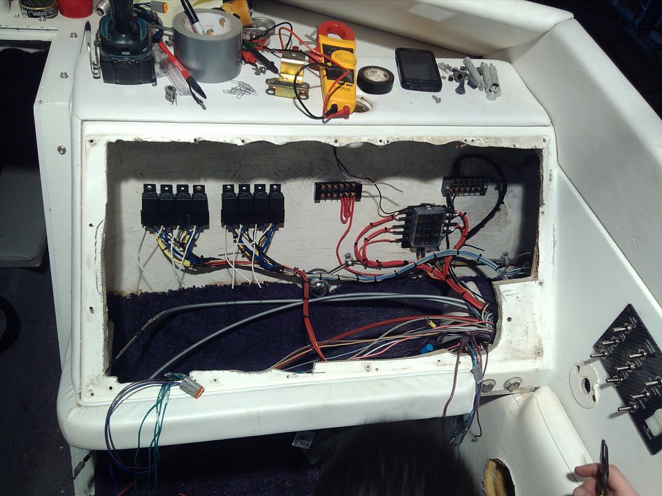

Last winter my project was taking my 88 fountain dash and throwing it really hard into the trash and making a new custom dash. The gauges are livorsi race style with white face and rings "No Bezels" I custom cut the dash out of 3/16 billet aluminum, and had it hydro dipped carbon fiber. All the trim,drive,and toggle switches were replace and relocated and Garmin GPS installed. The drive and Tab switches were replaced with stainless illuminated buttons. the rest of acc switches moved to a custom side panel. I bought EMI Elite controls, and imco steering to finish it off. All the wiring was removed and redone with relays and power panels for lower amp usage. I think it turned out pretty awesome for a concrete worker and friend doing all the work. We also installed an insane stereo system...Attachment 488957
