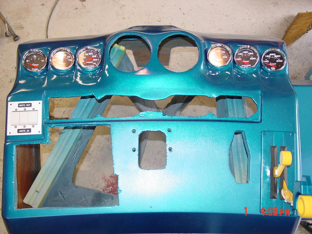

Are you talking about doing something like this? If i EVER get my boat done i'll die a happy man!

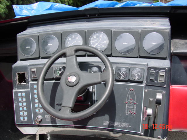

This is the before and after pic of the stock dash on my 222 Stinger....i wanted monster gauges but there was no room...so out came the cutting wheel and fiberglass and the result is the blue dash.....i didnt have the speedo and Tach at the time but you get the idea

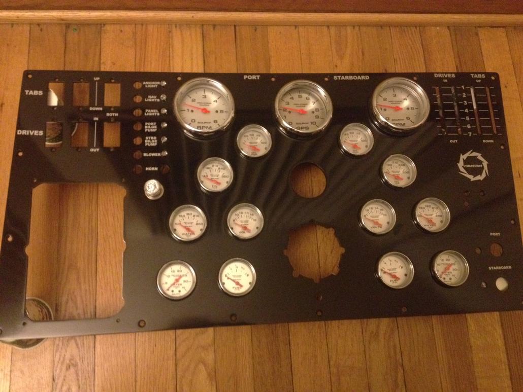

Heres a pic of my dash makeover this winter. Pretty uncool and basic with the panel setup, but works just fine for me.

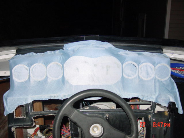

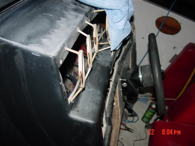

Its all from my car audio days making fiberglass box's.....easiest way to do it (in my case) was to cut rings out that fit the gauges and to glue them in place using wood dowel rods...then cover it in fleece or some other stretchy material (I used a sports jerzy material) and then start the fiberglass process and build layers....
From the pics below you can see how i made the frame work to hold the gauges...then i glued the blue fabric to the gauge supports...when it dried it was stretched out and glued to the main body and then trimmed...then multiple layers of glass were put on....then the sanding and filler...then primer and then paint.
