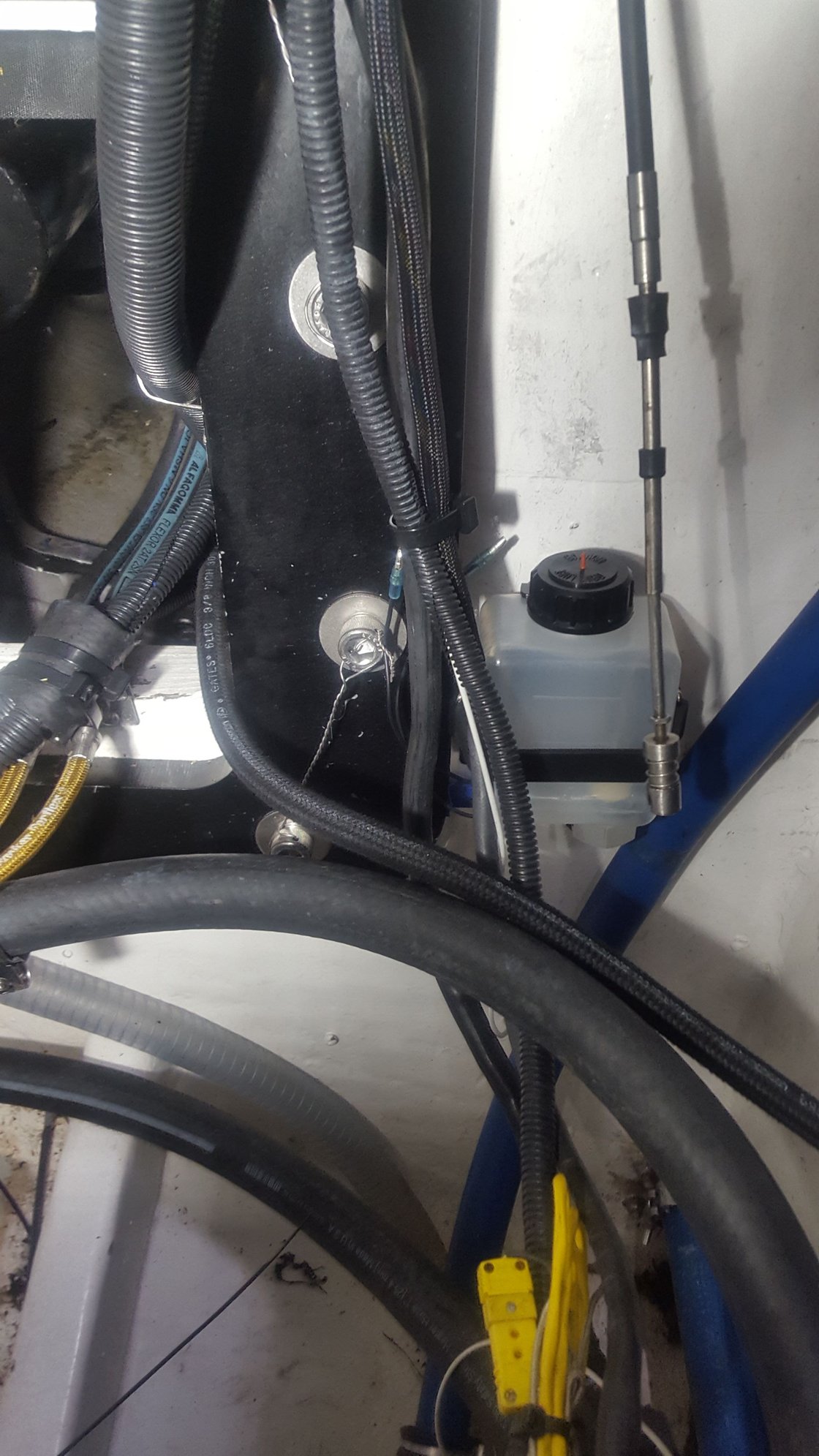

Worked on the drives today under my new Corona Lite Tent.. Guess how I came up with that name, see below.. Anyways I decided the upper gear sets needed an actual way to check the oil without pulling the inspection plates. So I ran a line off the top of the old fill tube fitting, and picked up a couple Bravo1 reservoir tanks. Going to mount them on transom at a level just above the factory reservoir on the gear set. They won't run fully dry sump now, but won't run dry with no warning now either..
Also have the tone rings on the drive shafts to monitor transmission output speeds. And speaking of transmissions, the Old Dominion freight line tried to adjust my shipping bill on freight back from Tyson's. We both Guesstimated the pallet and both transmissions weighted just under 350lbs. Well at the terminal in Joplin, they claimed their scales weighed them at 1900lbs.. So I get a bill for $500 extra shipping.. Lucky for me, due to my covid lockdown, they are both still on the pallet in bed of my truck. So I took a ride back to the terminal to re-weigh the load.. Now I know for certain the transmissions weight no more than 150lbs each. And the shipping company owes me a rebate on 40lbs of freight.. Pretty goo guess I would say..

Other progress of the week. Think I finally have the gear reduction boxes oiling sorted out. The two gear, port side unit seems to have been operating and oiling fine so far. However the four gear starboard case, seems to have pumped itself dry before our last trip out. I purposely overfilled that case, and most of the gear noise went away. So while down, I pumped all the oil out of both units, and the evidence was pretty straight forward. Port side oil looked like new, while Stbd looked like it came from the rear differential of a 300k mile truck. And most of that oil only had 45 minutes run time on it..
To evacuate the dry sump tank and lines, I pressurized the case with air hose through the fill tube, and took that feeds the pump, and stuck that in jug. Quickly learned that one, there was no vent port on that case. Second, one of the external alum tubing lines was where all the oil exited the case. With the setup how it was, the fill tubes were also the dipstick tubes. Stick a wire down the tube and try to read how much oil is in the sump case.. I understand dry sumps, but when they run dry, they really suck,, air..
Last trip out I overfilled that Stbd case on purpose, where is had oil about 1/4 way up the gears. Noticed no power robbing issues, just didn't scream "I'm Out Of Oil" any longer. So after we inspected the pumps, found not bearing damage, the only thing left was make sure they don't run out of oil. On port there was a factory vent tube, so that one just needed the reservoir bottle with float switch plumbed up. Starboard also needed a vent tube added to the case. Which we did by connecting a 90deg hose fitting on top of the dry sump pan, and routed hose fwd through the extension boxes to the Bravo fluid tanks.
Easy enough right.. However plumbing is, and always has been my weakest skill. Can't make chit run down hill I've been told before. So when I mounted the bravo oil tanks, I was thinking I could keep the oil level in the case right at or about the same level as the dry sump case. But once I filled the clear plastic tanks, I noticed they didn't gravity drain into the gearbox as I expected. And I could easily blow air in the vent tubes back into the tanks, and get bubbles before oil. The tanks would never drain down enough to trip the float switch and warning light if they sprung a leak.. Ah crap, I really do suck at this... But I decided to draw it all out on paper, and soon realized the 90AN fitting on top the dry sump reservoir, along with my hose routing was at least two places for air to get trapped. I raise the tanks up about 3 inches, where everything runs slightly down hill, and it actually drained with cap off tanks. But still drained slow with cap on.. Bravo oil tanks have that little one-way vent in the cap.. Scrapped that, remounted the tanks a few inches higher, and wow it works as planned with no air trapped in the system.
Only down side is they are now not fully dry sump, both cases have about half the lower gear submerged in oil now. Which also cut the distance the rotary vane pump need to pull by half.. So no leaks, and we'll soon see how it works out.. Might cost a few HP, but right now we have plenty to spare..

Gotta give these kids something to keep em outa trouble.. Half dozen people around here with no previous skills, now know how to do fiberglass repair.. Last one actually ask if maybe we should test this draining principle before mounting those reservoir tanks. I said don't be stupid, drill those dang holes, Agian... LOL
