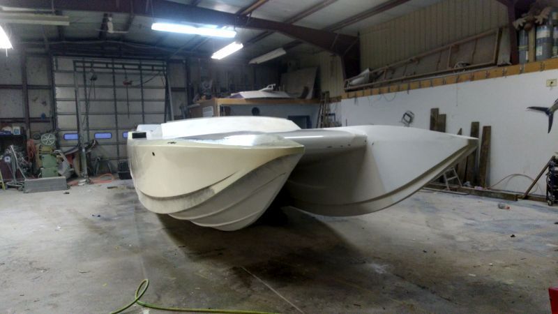

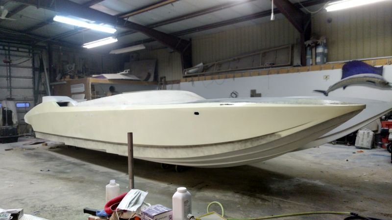

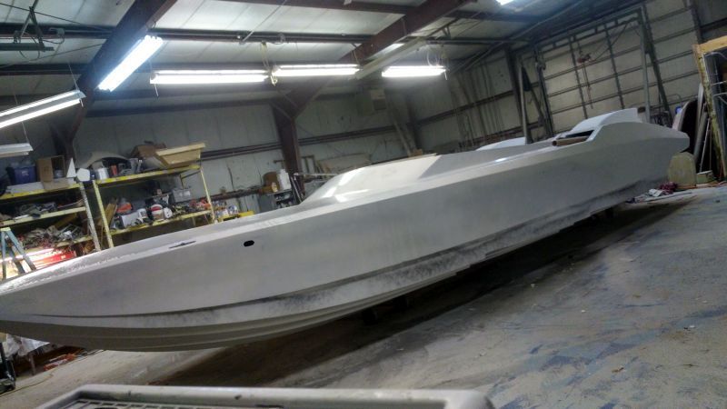

wet ***** lol . . . had to slash off some dust while doing some finish work. Got the deck and sides sealed and wetsanded and finishing up bustle and cockpit. Its nice to see it mostly one color aside from the little sand throughs. I actually prefer to see thin spots when finish sanding it tells me the final surface will not be to paint material thick.Spray rails on both sides still need a quick DA still mapping out where my break lines are going to be. With no rub rail its a bit of a puzzle

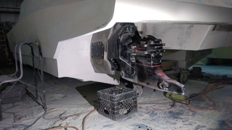

some updates for the admirers got the drives mapped out and had to adjust the tail of the bustle a bit but no biggie. Clearances all seem pretty good, may not get "trailer mode" out of the trim but more then enough to get the job done.

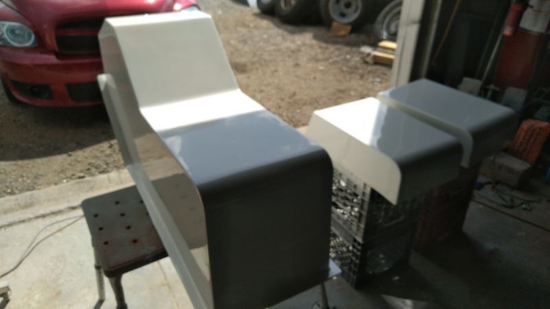

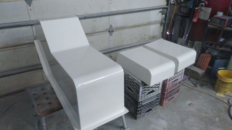

Started getting some paint down, want to get all cockpit stuff done and buttoned up. Custom seat risers and one of my consoles (thanks Jack )

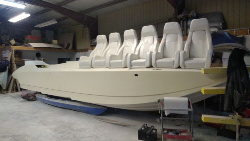

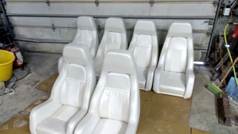

got the seats from my local upholstery guy, i made a shell mold off a seat i had in the attic and my guy did the foam and patterns in carbon fiber pearl and a tight grain white, looks good also did a blue flat stitch around the outer edge
