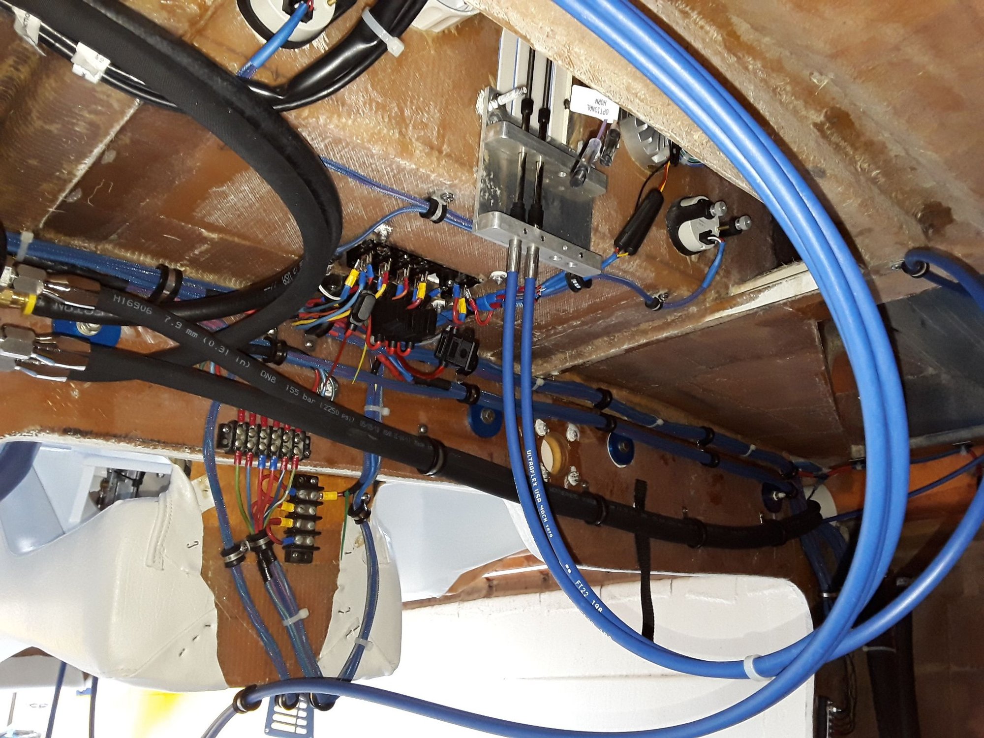

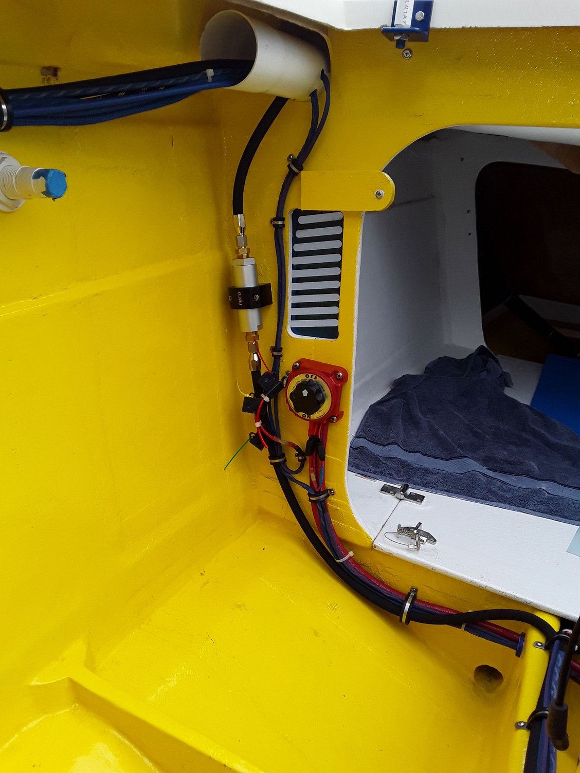

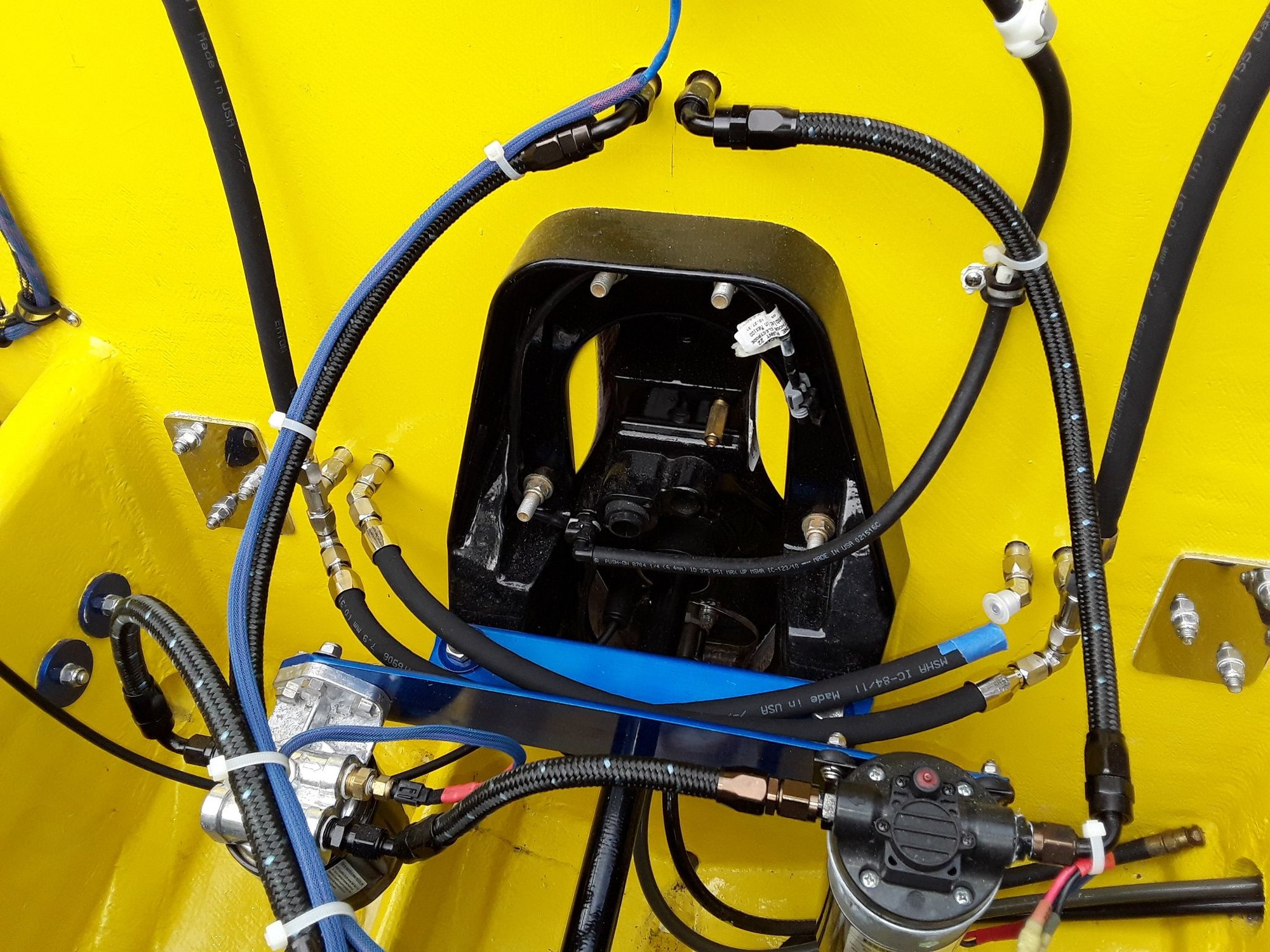

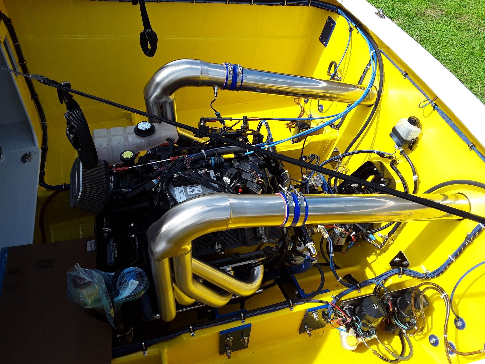

Its no powerplay wiring job, but i tried pretty hard.
Tough to get good under dash shots, but it looks nicer than the pics show.
There are 3 circuits, 2 from the battery switch, one for the accy's, the second just runs up to the dash and stops at the terminal connector, pop a fuse in it and add on.
The third is the engine harness and its only used for the ignition.
The circuits are marked at the battery switch and under the dash with red yellow and green zip ties.
The red zip tie on the fuse and the fuse for that matter at the battery switch both have to come off
since the harness is the third circuit

Old 08-29-2018 | 08:04 PM
  #134
jeff32's Avatar
Joined: Jun 2004
Posts: 8,231
Likes: 580
looks like a very nice job to me!
