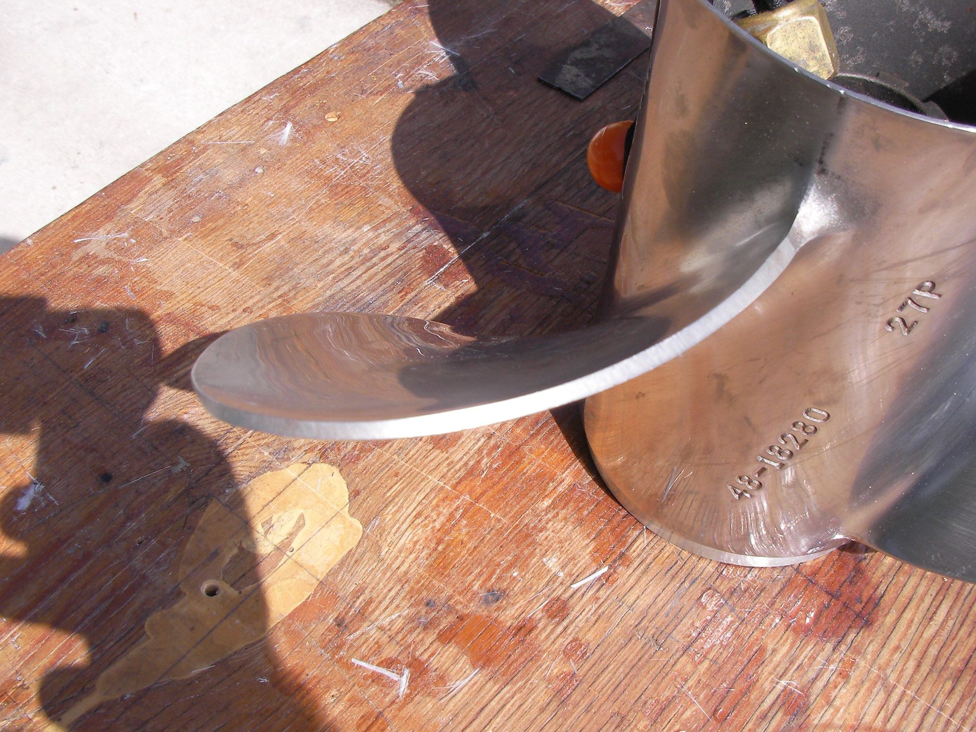

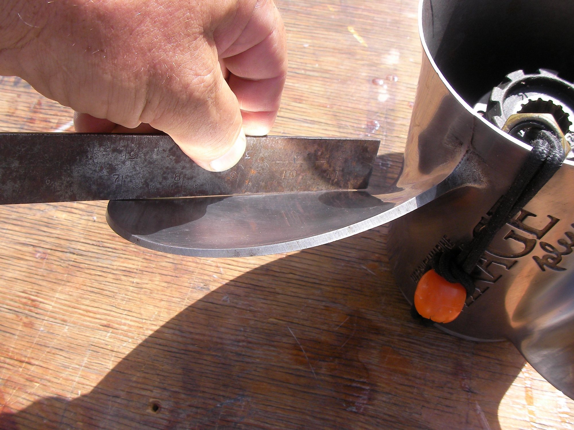

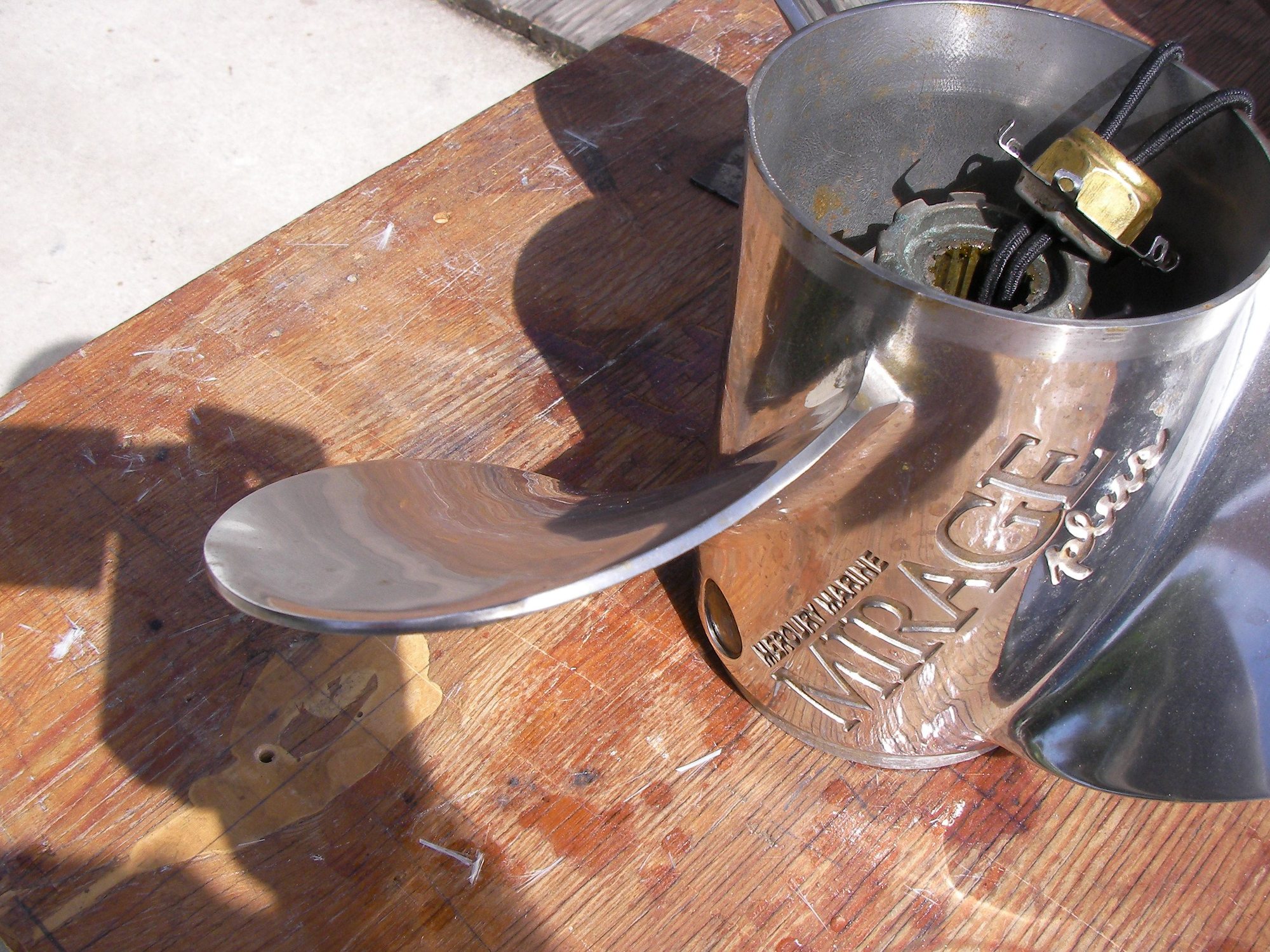

The 25 m plus is from the pair that was on my 30 scarab, they where modified from the rake angle up to the cup along the diameter, i sent it to a prop shop to return it to stock, they said they did. To me its still in there and i reconditioned props for 4 years,
used to use the old gauges too, wish i had a diameter table and gauge now.
it chinewalked very bad so i cut the ring down 3 times 1/8" at a time and it improved greatly.
it likes to run parrallel to maybe 2-3 degrees trimmed up.
the chinewalk is 95% percent non existent, total confidence to let it run but it goes into the soft limiter.
the 27 m plus really looks box stock ( no where near as progressive on the rake angle) and it has the whole ring on it.
it likes alot of trim 5-6 on the indicator (2 is parrallel)
the chine walk is 95 % non existent, total confidence to let it run but it only turns 4900
other difference between the 2 props is the 25 has vent holes that are plugged, the 27 does not have them at all.
without the spacer the 25 and 27 jump up on plain and i take it easy getting up.
both props cavitate around the 1500 mark for 1/2 second, then once the bow falls and until the boat settles into 2700-2800 rpm any input to the wheel or trim and they will cavitate.
the cavitation is a 50/50 thing it will either bark at you or it will howl and vibrate and you have to start over.
with the spacer cavitation is gone at the 1500 mark, and virtually nil with input once up on plane.
the 25 now stays inside the limiter and wants alot of trim 5-6 on the indicator, but speed is down slip is up and bad chinewalk is back in my life so i didn't see a reason to try the 27.
without the spacer the 25 gets 73 @ 10% slip, the 27 gets 74 @ 11% slip.
plan to remove spacer, cut ring on 27 and cross fingers.

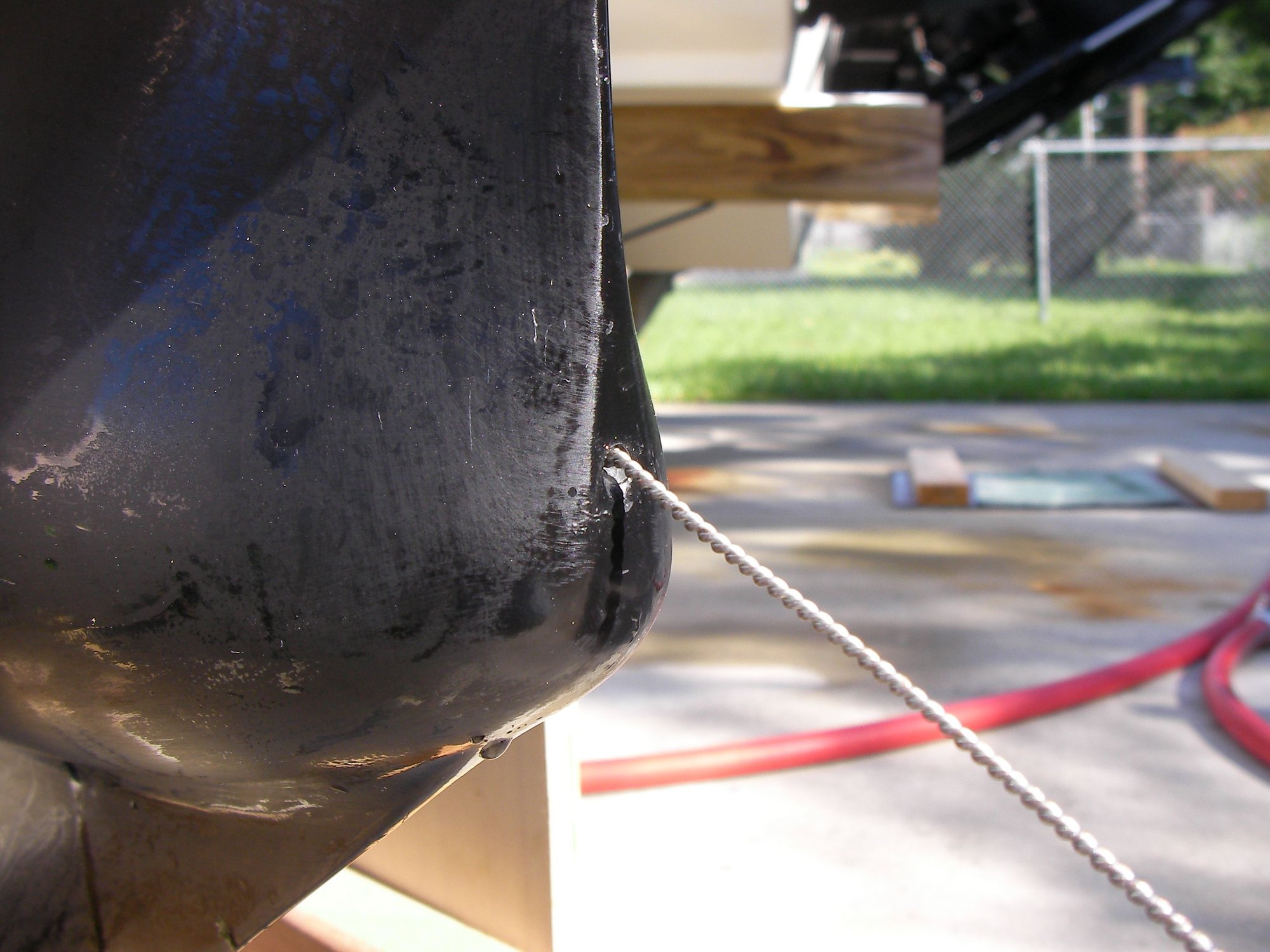

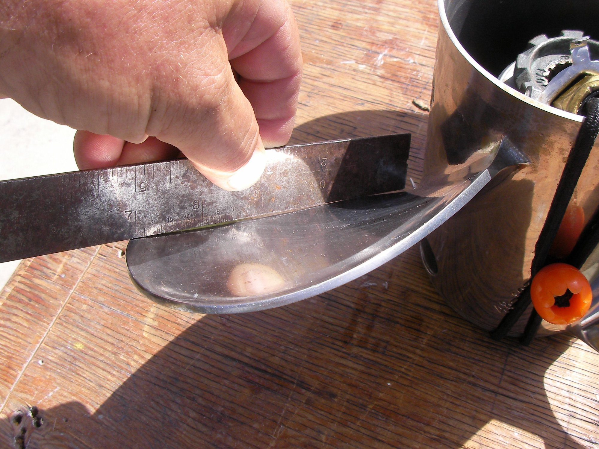

i'll get a couple pics with the straight edge to show the rake early tomorrow before the hurricane panels go up.

i dunno, the more i look at and feel the blades i dont think the 25 has any more, it probly is stock or damn close.
the finish could easily be throwing the look and touch off.

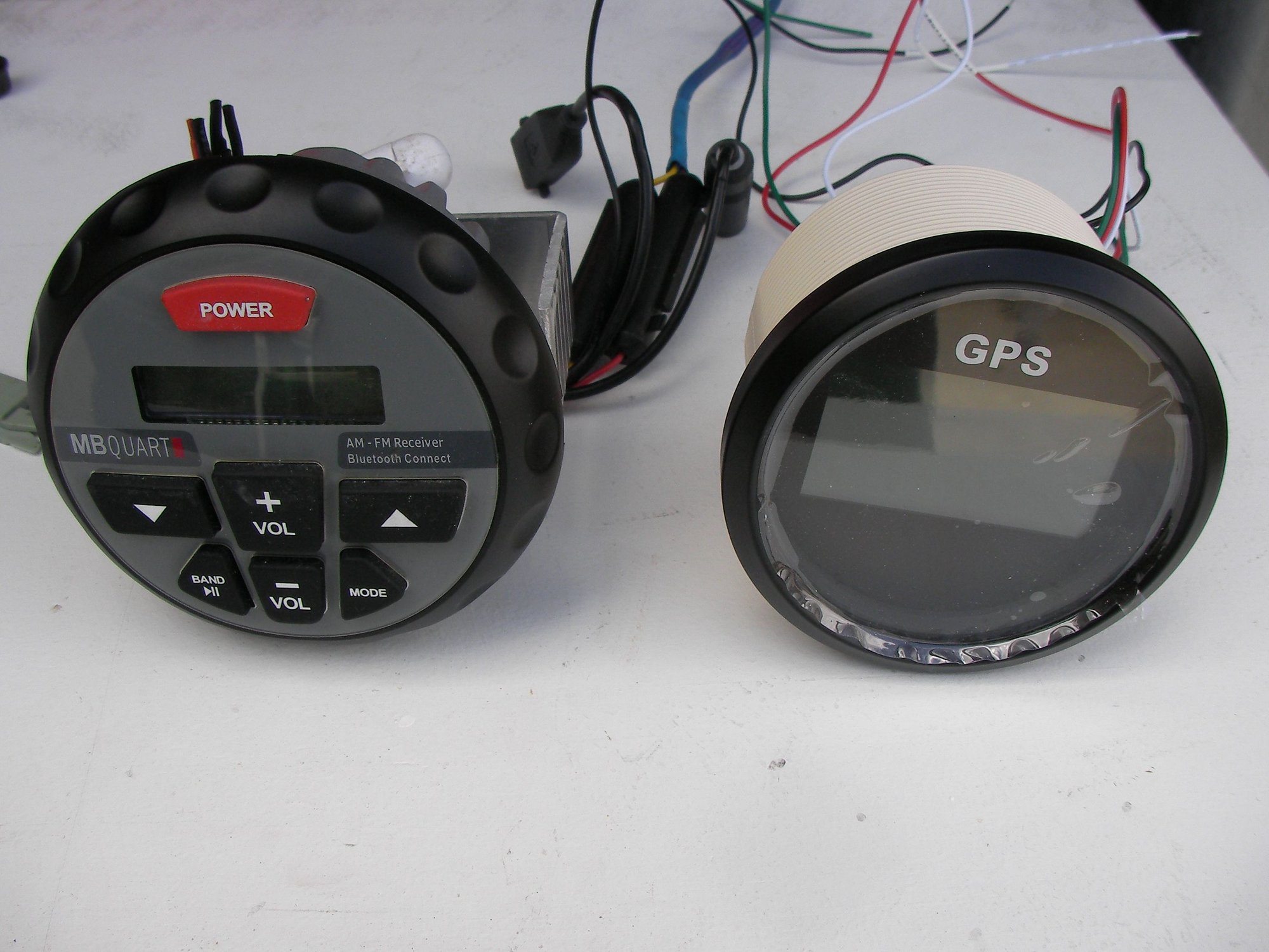

Took the radio out to use in the ski boat, swapped in a gps speedo (for75 bucks i'm sure it's accurate)
I'll go with whichever one tells me the fastest.
Snuck the antenna and on/off button thru fuse sockets, all fuses under dash.
Even with careful drilling, filing and fitting i still managex to screw both sockets up a little.
