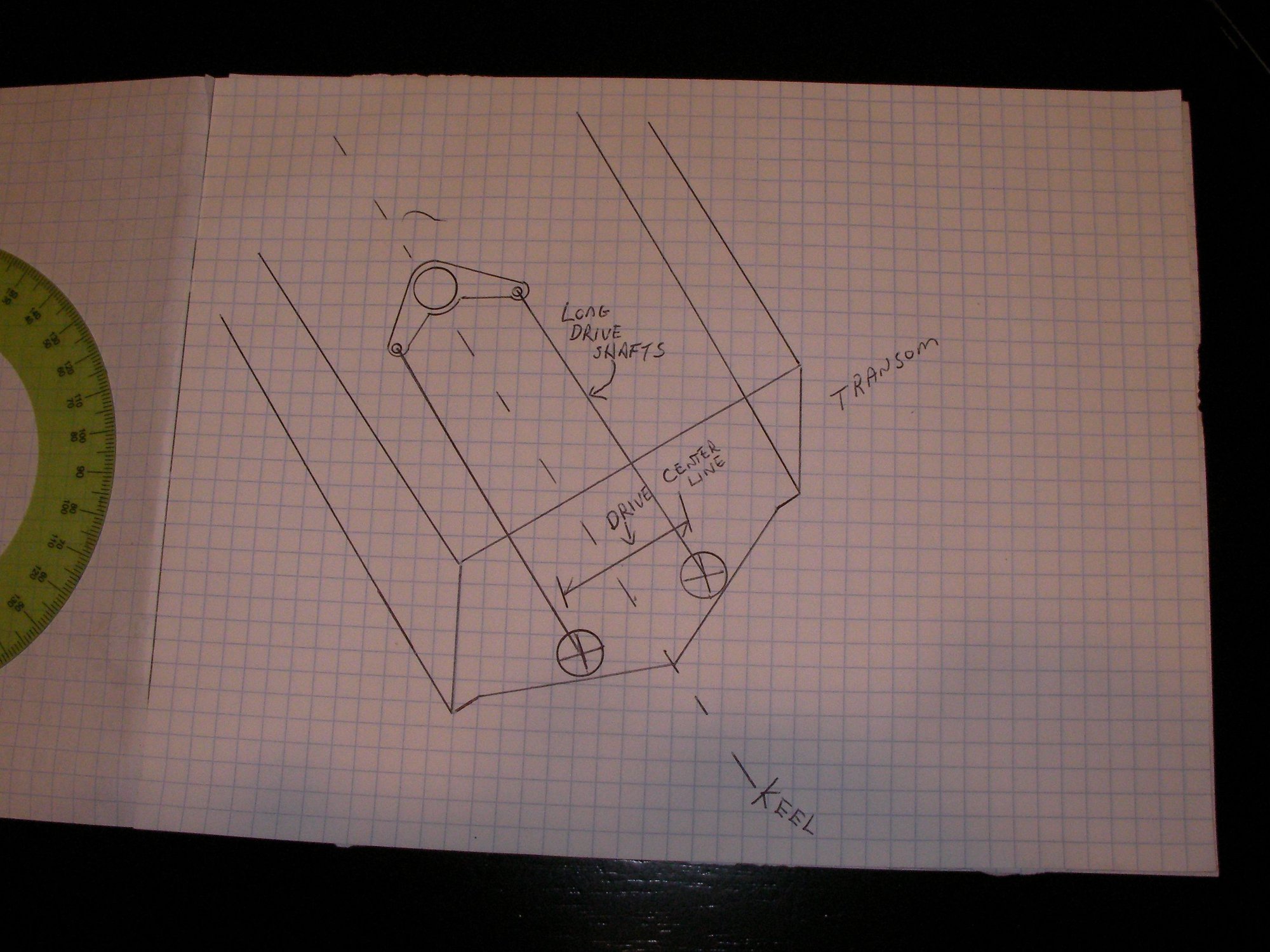

by the looks of the project, all the work you have put in, the level of craftsmanship you have and some other projects you have completed or been involved with (what i gather from reading this thread), my opinion is you know what has to be done but since picking outdrive centerlines and propshaft heights are the hardest decision a man can make in this world, your doubting what you know.
I would put a new transom in and remove the notch and temporarily mount the drives at 20 inches in between and as low on the transom as they could go.
i think your putting the engine in backwards with the split case forward in the engine room with the drive shafts running back the the drives.
the longer shafts will reduce your cv angle.
sorry for the hand drawing, the sand leaked out of my etch a sketch
https://cimg1.ibsrv.net/gimg/www.off...220544b7c7.jpg
ksalmine 02-18-2021 02:37 PM
1 Attachment(s)
Thats exactly what I'm doing, engine is front in back, transmission on the bow side. center off gravity goes little back when heavy engine is as close to transom as possible. 6" exhaust is also shorter and lighter. 60mm waste gates will have own 3" tail pipes, Sound may be awesome when ports open, like P51 mustang at full song, love it!
I like put drives closer together but it will raise the engine. Another problem is drive shaft angle, it makes 4 degree difference if drives are closer together like in drawing. It's back view of boat.

So 4 degree and 4320rpm at 2000nm is not good. Drives could be mounted maybe 28-30" apart, outer places in drawing is 32.4" and inner 23.2". If there will come some prop slip or other weird problems, let's figure them out then.
Drives are not ASD's, they are self made. Shaft flanges move along trim and steering so drive shafts move little every direction. There must be some clearance to engine frame.
By the way, dimensions in drawing are millimeters.

outonsafari 02-18-2021 04:07 PM
Awesome, engine backwards is the only way to go. I see what you mean about rpm torque and angle.
in that case i would move the drives apart until shaft angle was zero or 1 degree.
side by side engine boats with 34 - 36 centerlines can go 100 mph, so why won't yours if drives centerlines are 32 inches
i would also make sure the transmission and split case can be removed from the boat without remving the engine
seems to me only from reading about other complex hi hp hi torque hi speed projects, the initial problems are always in the transmission and shaft angles are always a concern.
you have a double whammy going on(complex transmission and split case) so make it easy to remove and work on.
i think it will work with minimal shaft angles and you will be happy.
keep up the good work
