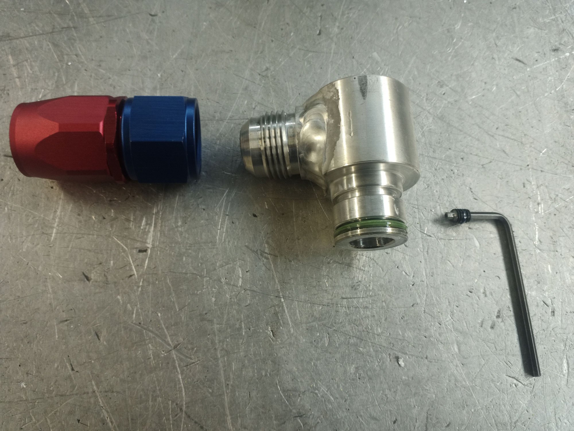

Oil filter housing is ready,
Distance between exhaust manifold and oil filter housing is tight, so special oil cooler connectors had to made. All valves are revised and assembled, some modification had to done, of course. I try control oil pressure by piston cooling circuit, when main oil pressure exceed 8bar, piston cooling valve open and squirt all extraordinary oil to bottom of pistons. If oil pressure is still high, Transmash original pressure control valve decrease the pressure. That way piston cooling is as good as possible. Piston cooling control valve can be now adjusted externally.
Pre lube pump pressure is pushed to filter housing from orginal Volvo oil pressure contol valve return line, that valve is not in use anymore. One way valve must also be installed.
There will be massive bundle of hoses on engine right side...
Volvo filter housing is good part to custom applications, easy to modify, large filter surface area, by-pass filter, internal oil thermostat and lot of any kind pressure outlets.
