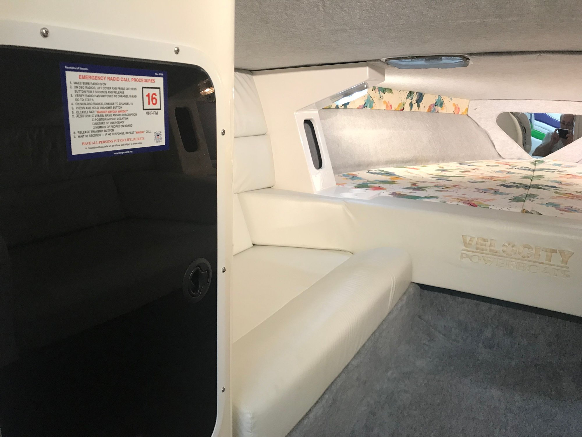

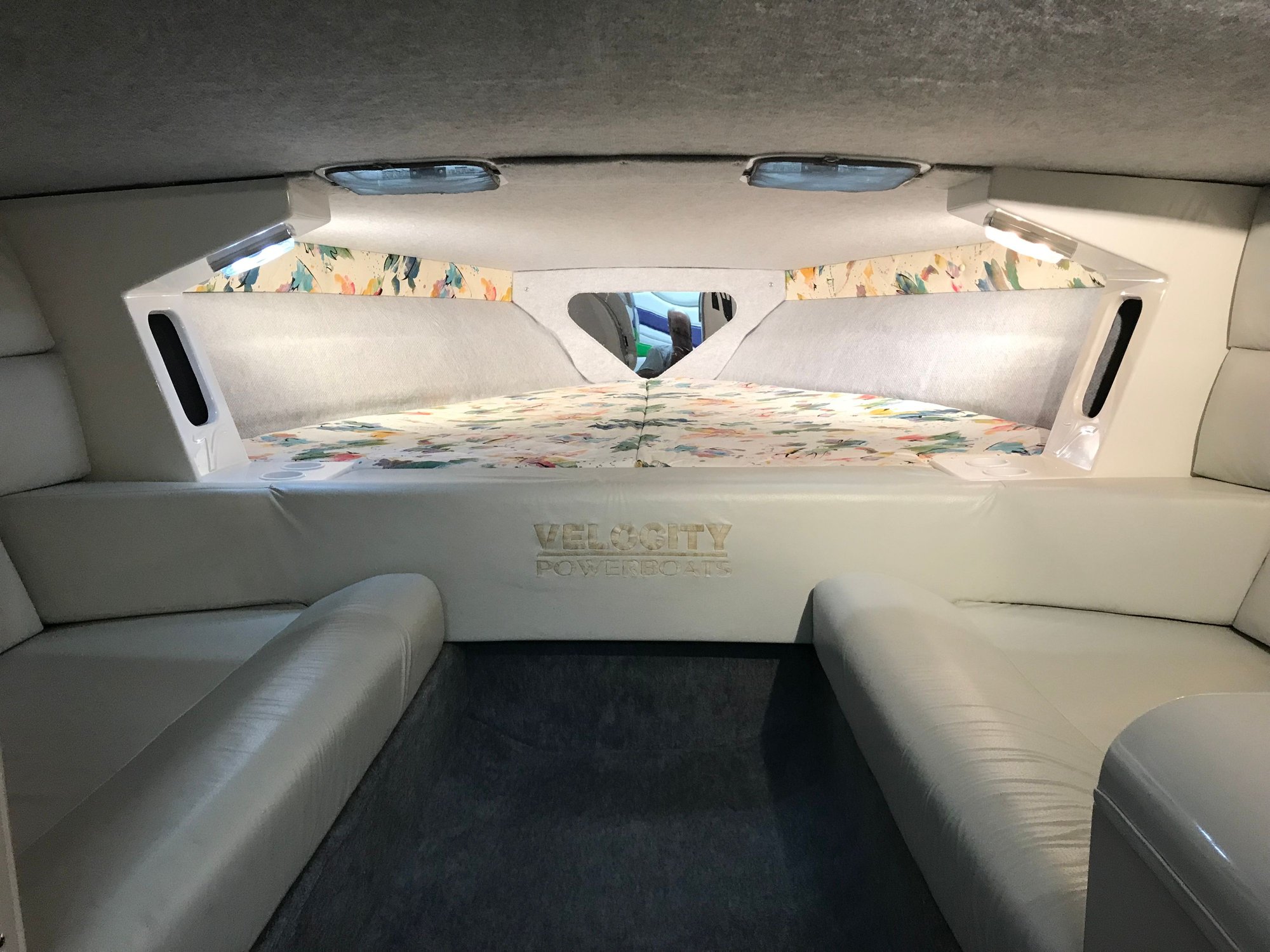

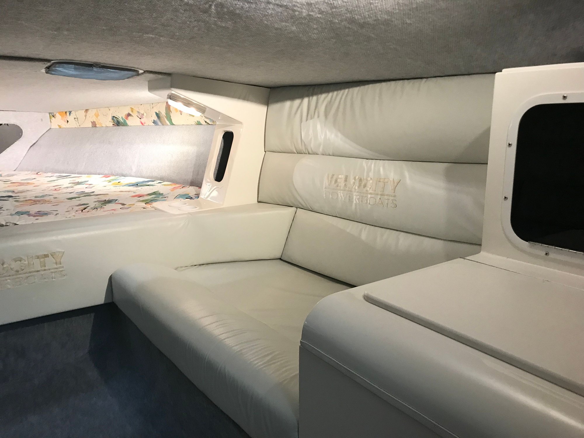

ThisIsLivin 08-03-2021 10:19 AM
It's finally done. Decided to redo the sound system at the same time and ended up rewiring a ton when I had everything apart.
https://cimg9.ibsrv.net/gimg/www.off...ae0f2dc789.jpg
https://cimg0.ibsrv.net/gimg/www.off...266d22265f.jpg
https://cimg1.ibsrv.net/gimg/www.off...4810342db3.jpg
