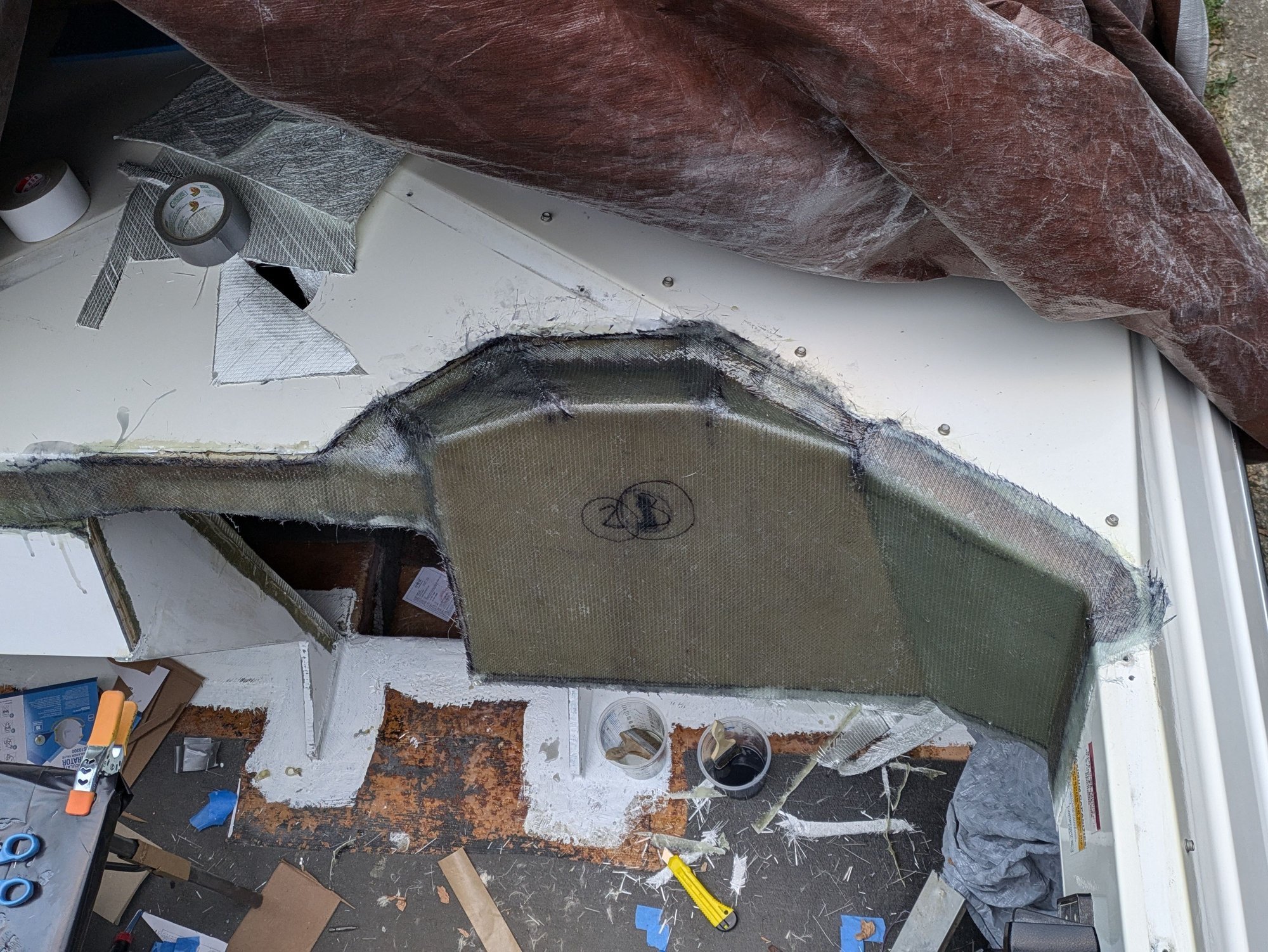

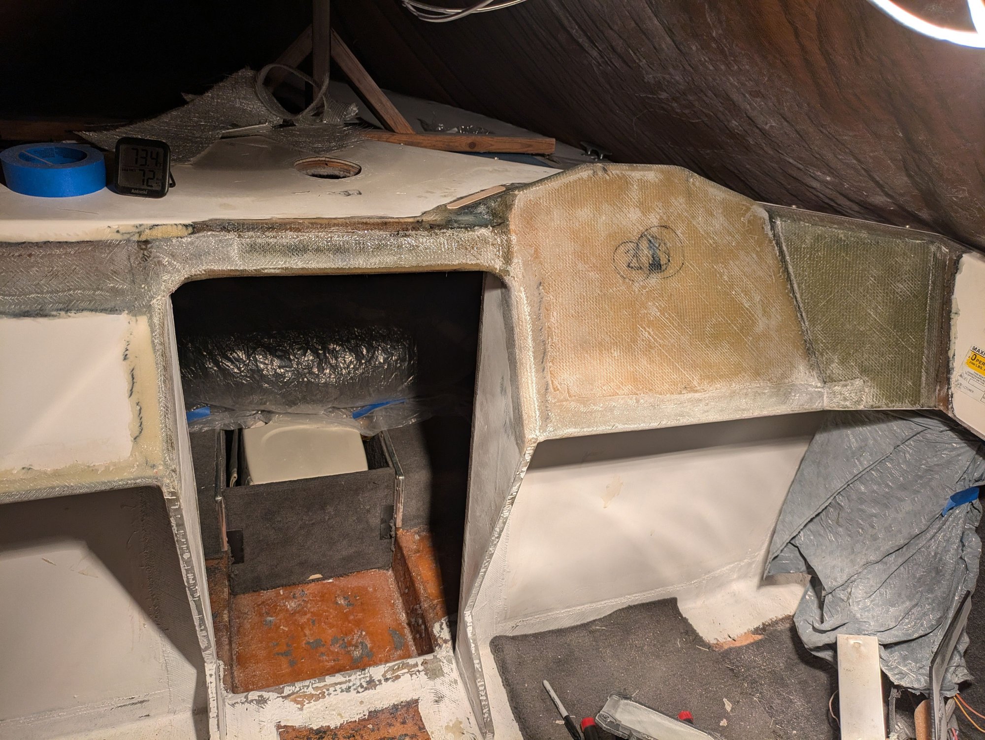

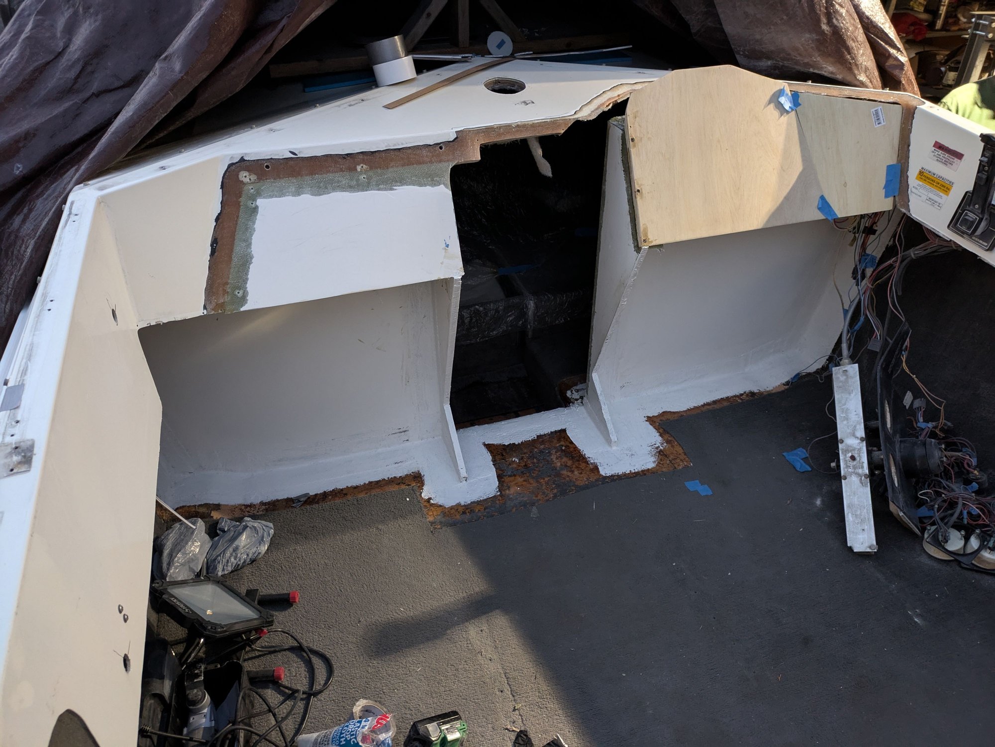

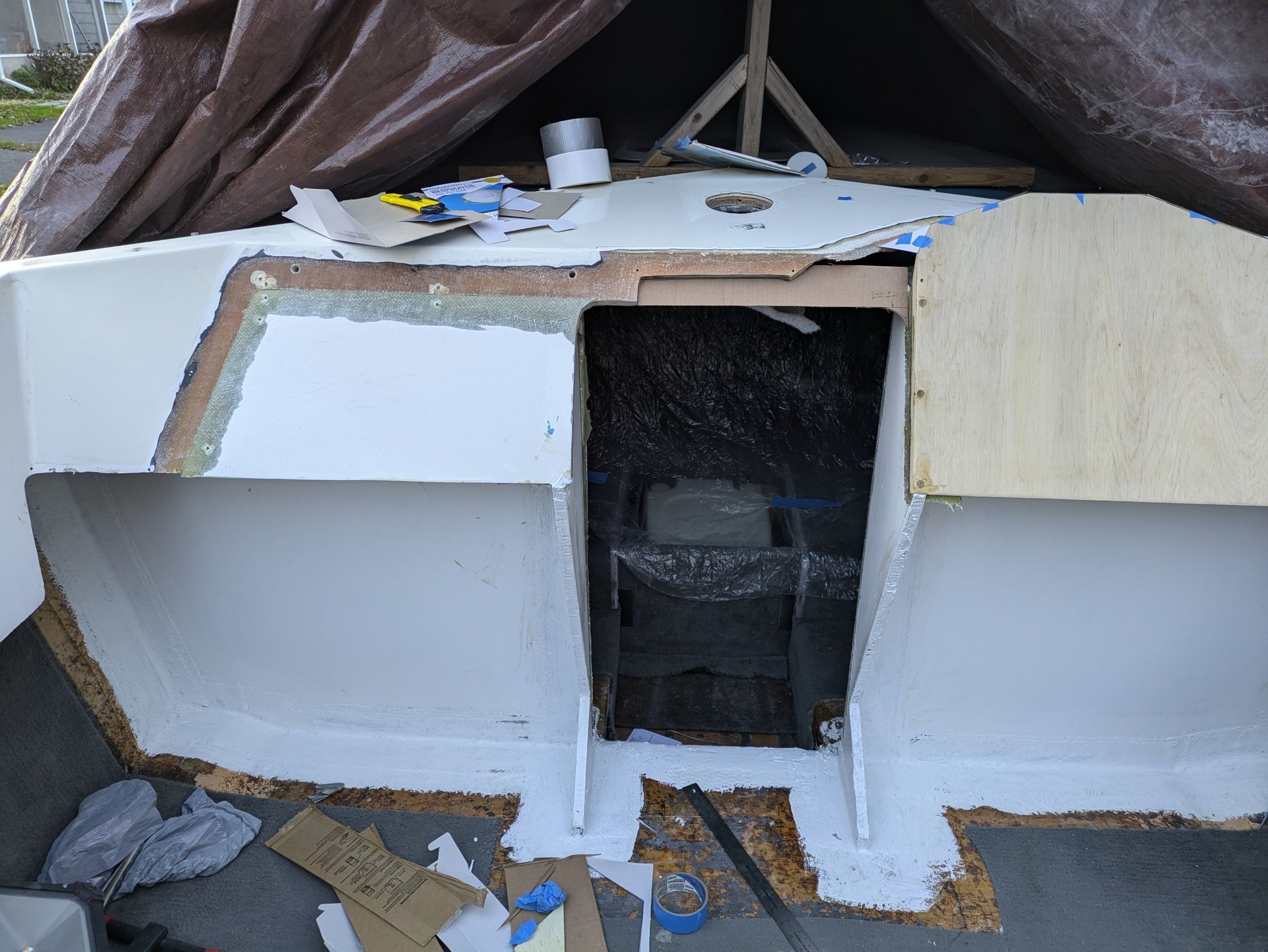

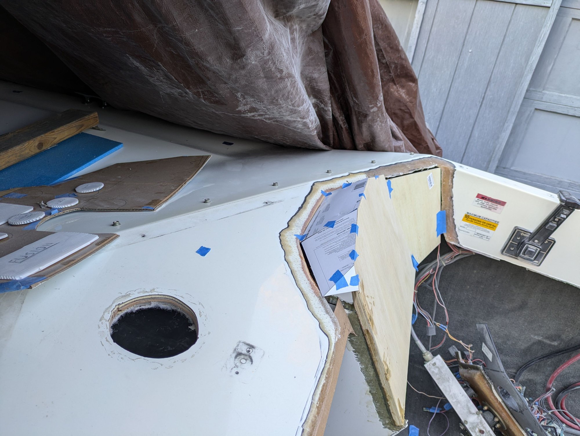

New dash support panels tabbed in
Building new dash
More f'ing templates
And more lol
My temporary filler molds worked out great to build the shape
2 layers of CSM and 4 layers of 1708 on top of core. 1 layer of 1708 to go on backside to seal everything. Feels very solid already though!

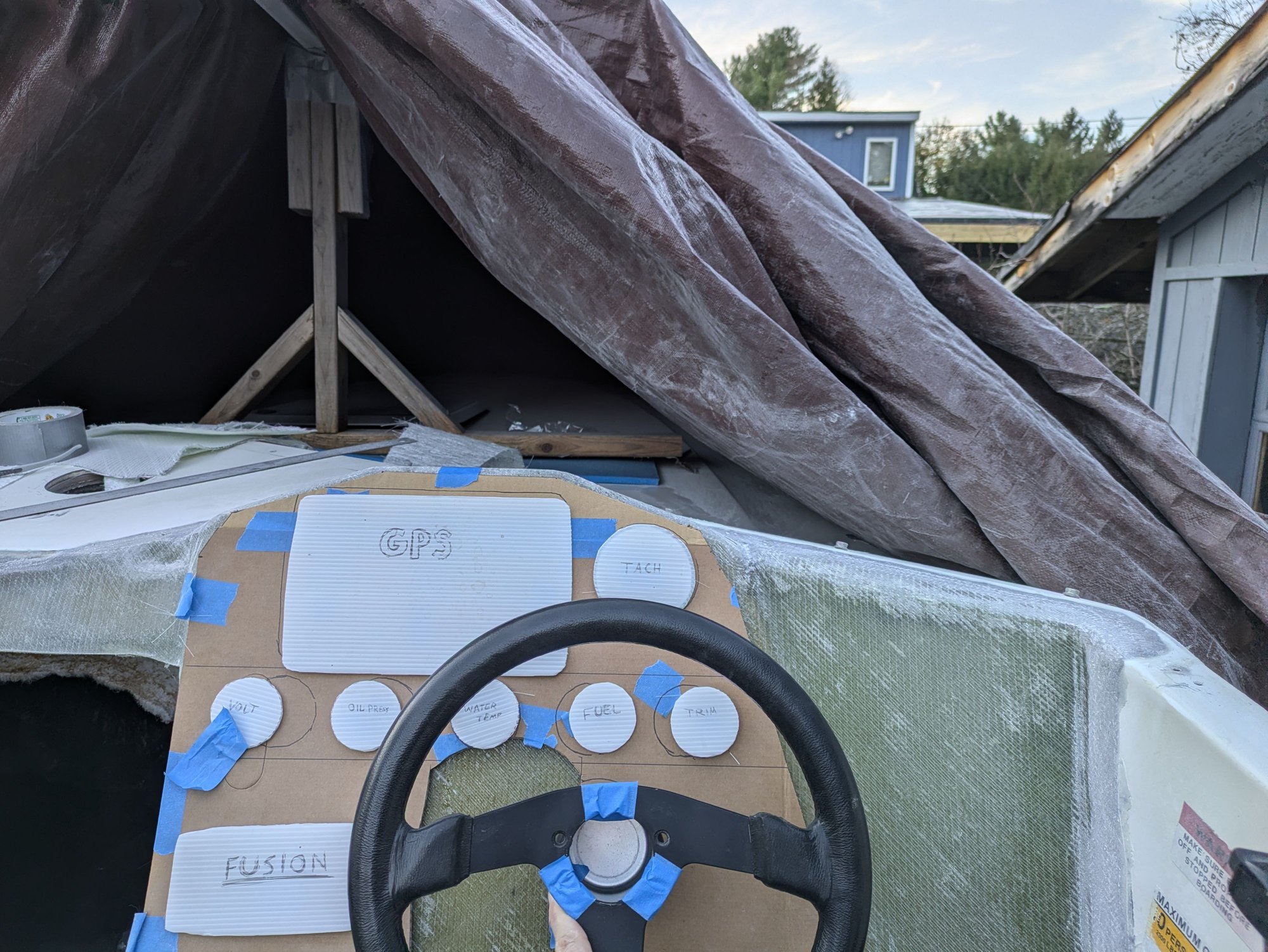

Gauge layout is going to change. This is bothering my ocd too much. Trim tab switch and switch panel will be to the right of the wheel... someday
So much sanding lol
Starboard dash fill tabbed into place on front side. Still need to glass a layer of 1708 on the back of both sides

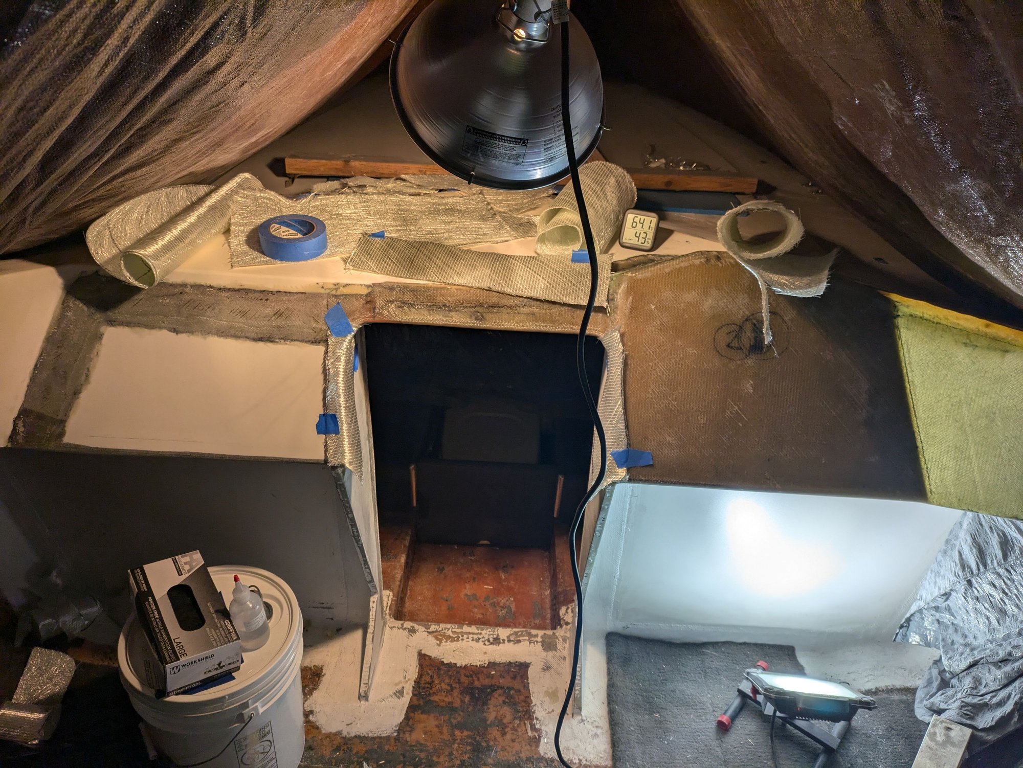

Cuddy entrance trimmed up
I think I'm finally to the point where others can see what I'm going for lol

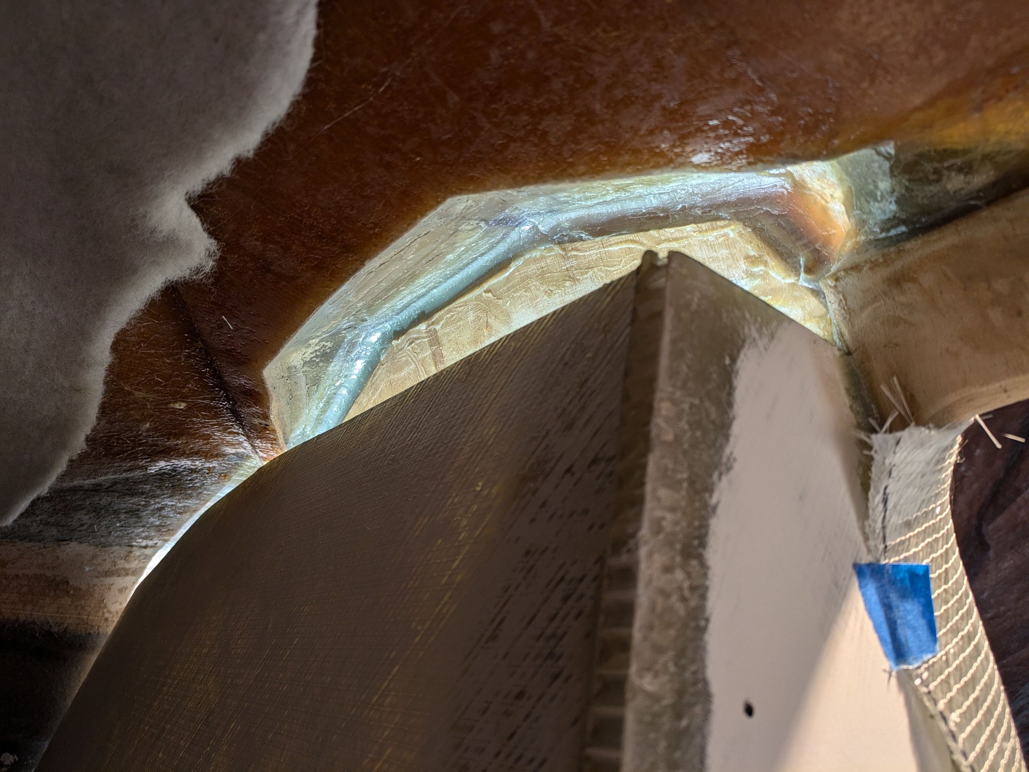

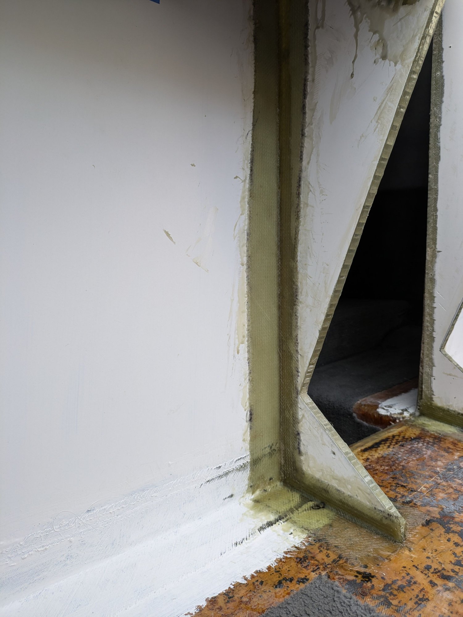

Getting the edges and backsides of the dash laid up so everything is completely encapsulated.
Underside of driver side dash. That's going to be fun 🙄

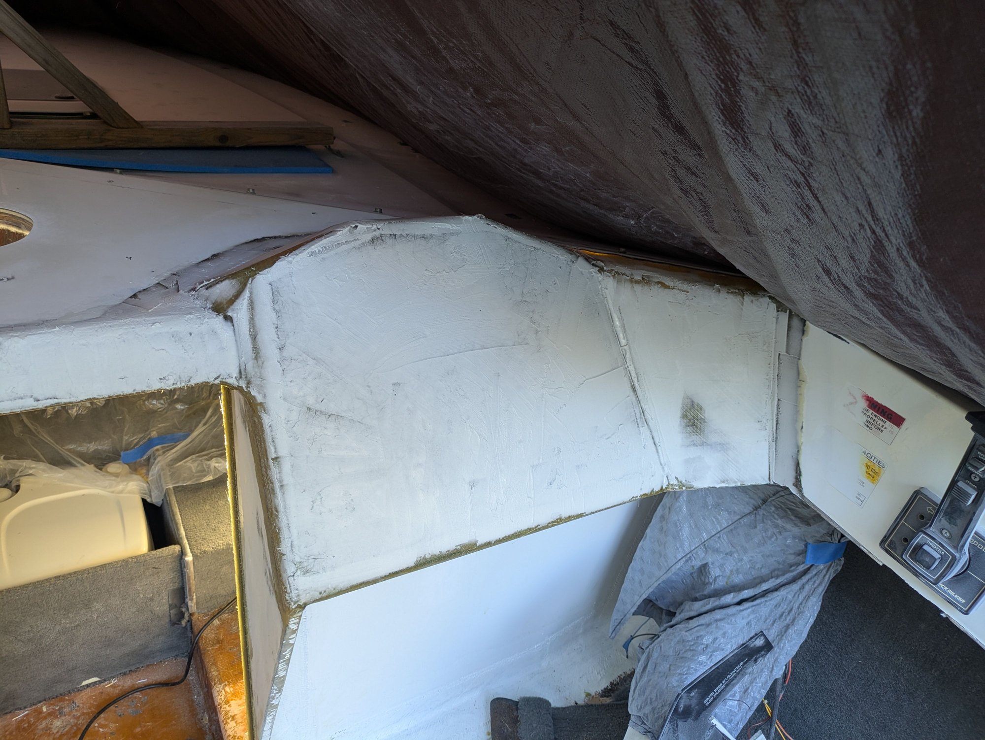

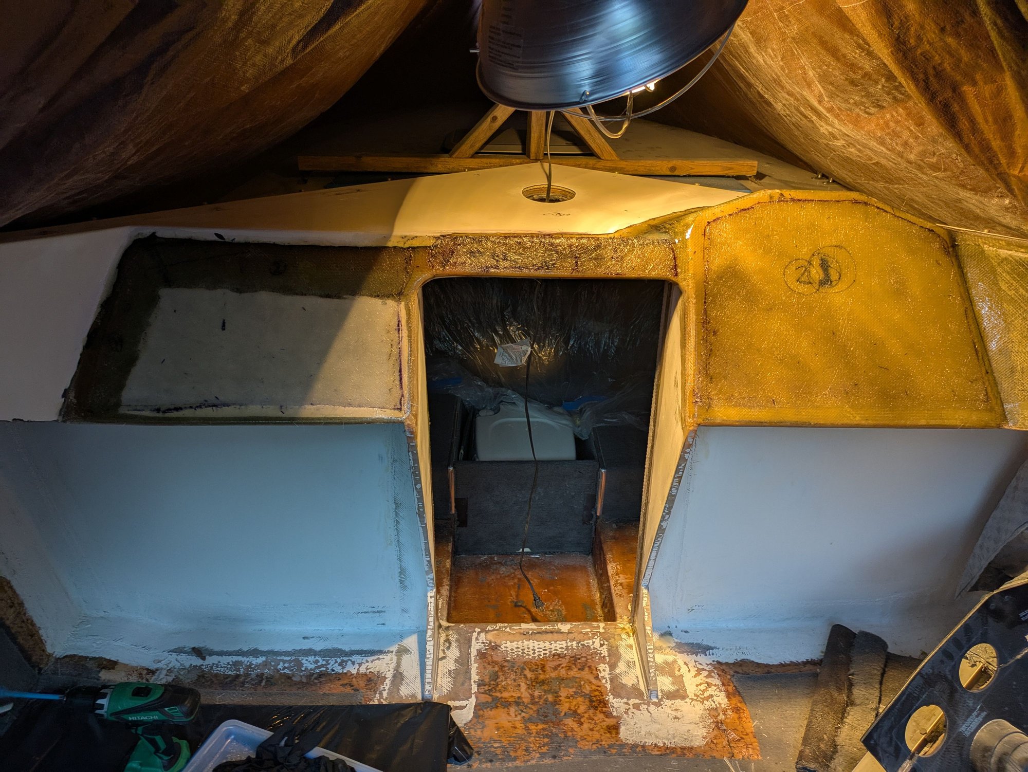

Got all the edges wrapped up in 2 layers of 1708. 1st layer on port and starboard side dash covers the whole backside and wraps up over the front edge.
Got some sanding done. The tabbed-in filler panel is pretty close to flush.
Got a couple edges sanded up pretty good. Only a few hundred more hours of sanding to go.
Really happy with how everything is coming together thus far. I don't think I'll have all the layups done in time for winter because the temps are dropping quickly and my heat lamps can only do so much! I have plenty of sanding I can do to stay warm though 😂

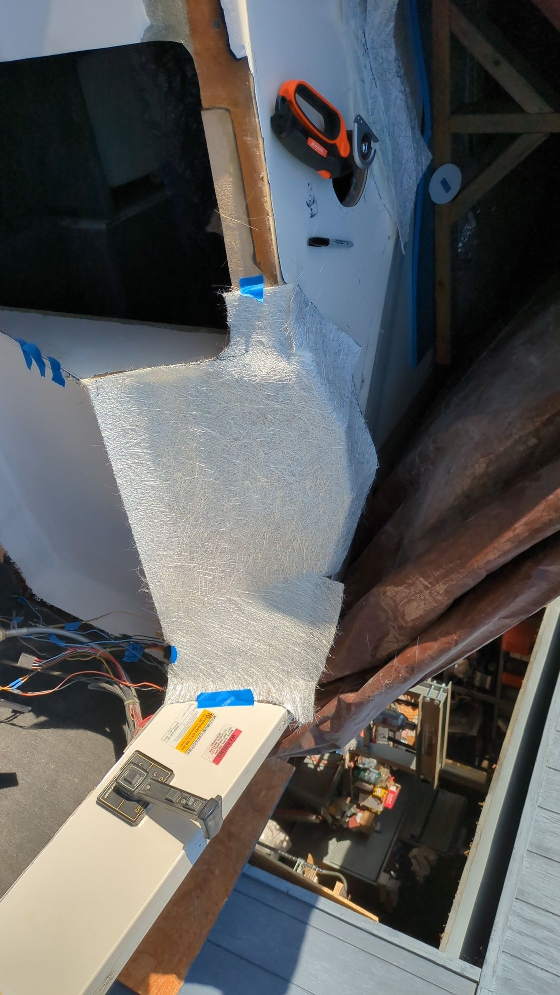

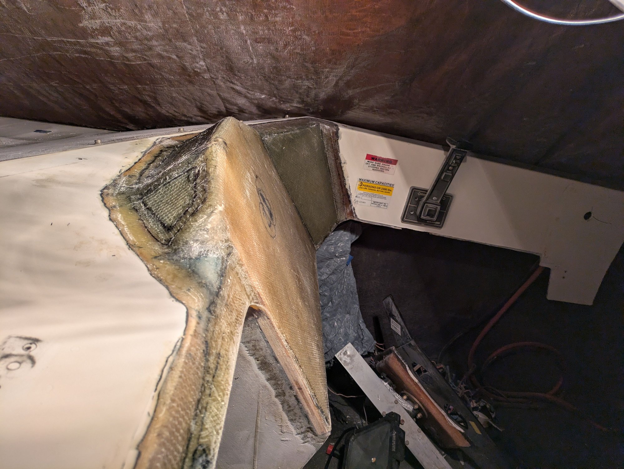

Laid up some CSM in the low spots on the dash so I don't have to use much filler. All my low spots are less than 1/8
Laid up some CSM in the low spots on the dash so I don't have to use much filler. All my low spots are less than 1/8" though, which was both surprising and relieving.

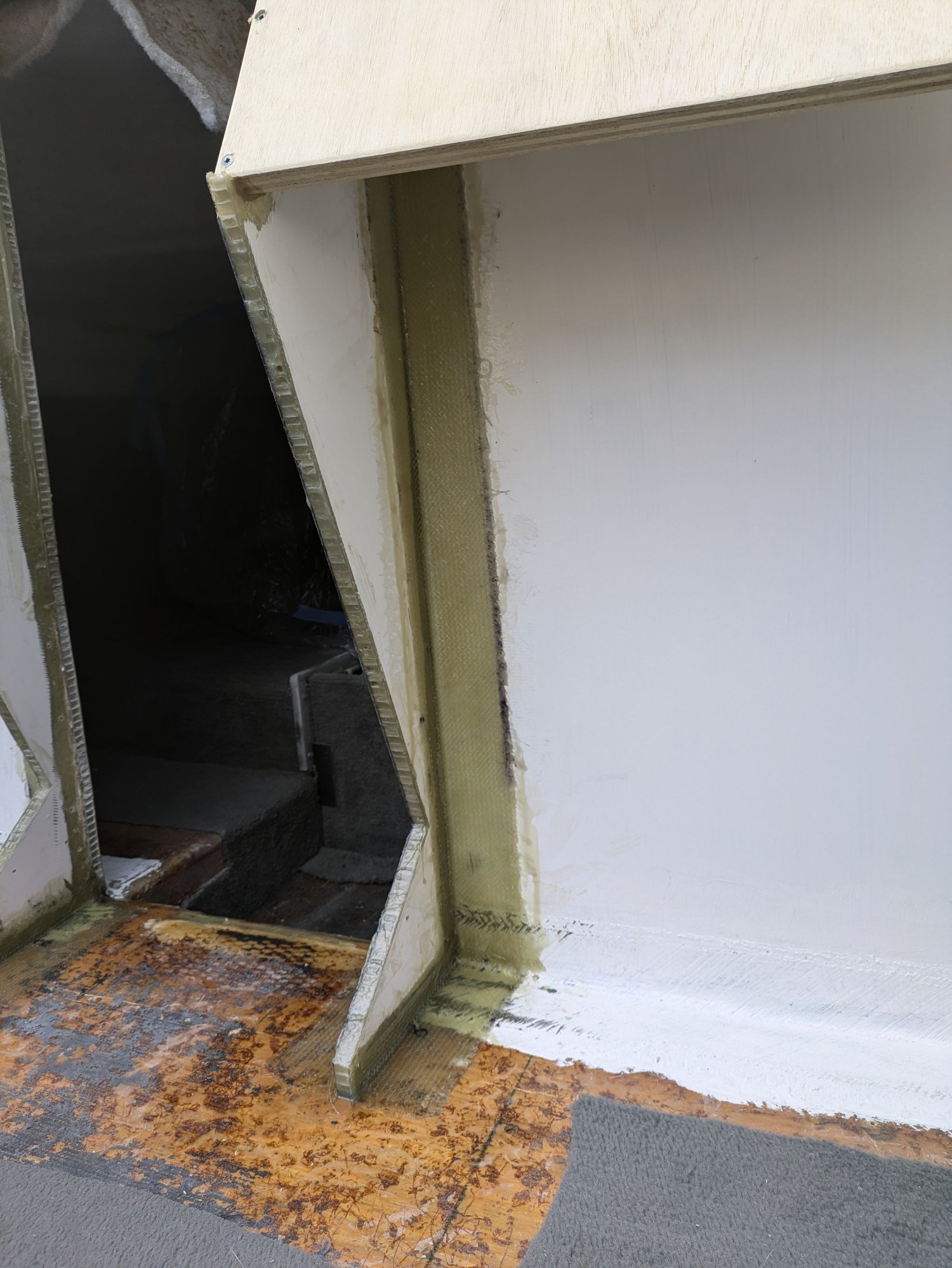

Needed to glass in a little extension here so that my cabin door seals better when installed. I guess my bulkhead panels weren't lined up 100% with one another. Why did I ever assume that the factory panels were square to one another? Lol
