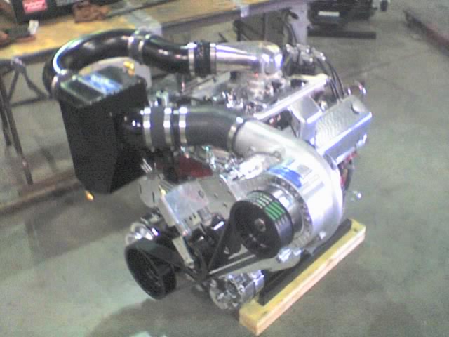

ok, so in the last year i've made a few changes to mine... but now im ready to make some more. i did the imco box and steering, and the box has the 3" lift. the boat ran a reliable 65 on the gps before with the old motor and the stock exhaust with a 28p b1 at 4200 rpm's( dunno why, but it did run better than a 26 at 4600) now it runs 72-73 on the gps depending on the water conditions with a labbed 26 b1 at 5750 rpm's. the boat handles way better at all speeds, but it is real lazy out of the hole(mostly because i lost torque when i rebuilt the motor and went to a much larger cylinder head). i am thinking about going to a shorty lower now, and i also need to figure out what size trim tabs to run now. my stock bennet tabs work just fine mechanically, but have almost no effect when running. my boat rides on the last 2-3 feet of the pad at full throttle, and for the most part doesnt chine walk, but gets a bad porpoise if the water changes at all. im going to be adding a blower this winter, and i figure it should make in the 850-900 hp range when im done with it. any suggestions?

Motor is 552 CI 8/71 blower with super chiller, aluminum heads , Made 820 Hp at 5600 rpm with 7 PSI boost.

i did do the dual ram hydraulic steering system when i added the box. the motor is is an 8.1:1 505 with a pfaff hydraulic roller and pfaff merlin heads. i built the motor with the intention of adding an m4 procharger, but i wanted to take baby steps before going ballistic. i ran a straight edge down the vee, and its perfectly straight. i ran the edge down the pad, and it has a 1/4"-5/16" hook at the tail edge of it. ive read alot of posts about the hook being placed there intentionally by the manufacturers, but im not sure if thats the case here. since im changing the lower, i think i may go ahead and just do the complete imco extreme. hot boat... my x dim. was 9 1/2" when i started this whole thing. the 3" box only raised the drive "theoretically" 3". after factoring in the angle of the transom, it really only brought it up about 2 1/4" from the bottom of the vee at the propshaft. i called dana marine and asked what they recommended for tabs, and they suggested the ht1100 tabs, which are 12"x30" long, but said they wanted to "kick" the tail edge up so they wouldnt drag. they also suggested to mount them parallel with the water line, rather than even with the transom. any thoughts here?
