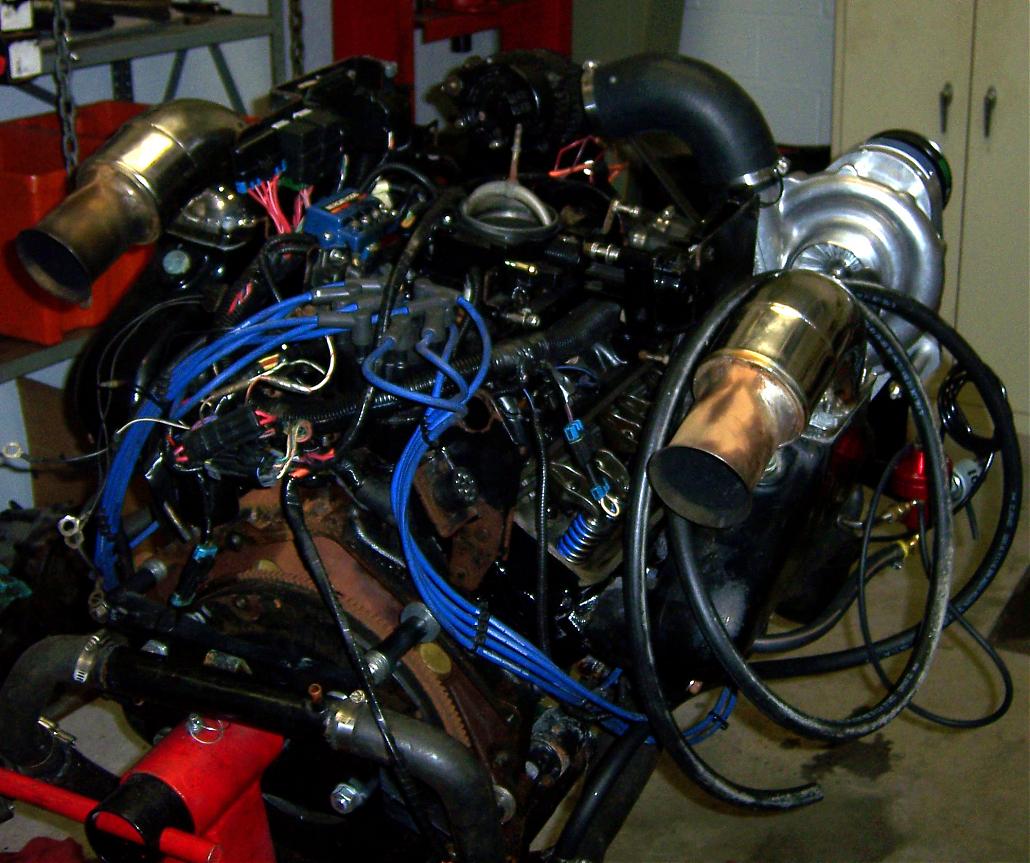

trc2 03-30-2008 05:22 PM
1 Attachment(s)
Attachment 333614
trc2 03-30-2008 05:33 PM
They were stock engines before I put the pro chargers on and changed the heads

did you have to pull the engines to install the pro-chargers?
trc2 03-30-2008 05:53 PM
1 Attachment(s)
Attachment 333617
trc2 03-30-2008 05:54 PM
Pulled just one to make it easier to install the pro charger on the port engine
