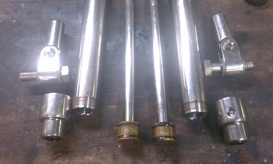

It's nice to take something apart and actually finding the problem right away. Boat would drift to the Starboard side and would need to be corrected every so often.
