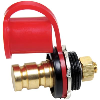

I am going with this setup, which I am going to install under the back seat, run battery cable from the accessory terminal on the batteries to the back of these remote terminals. I'll keep them capped when not in use. There's a Summit retail store/warehouse within 50 miles that stock these as I am going there anyway.

The short coming of terminals under the seat is that you still cant open the hatch in the event that your actuator dies, they are only good for dead batteries. They are quicker and easier to hook up cables to, but for the occassional need for them from dead batts, you can actually just hook jumper cables to your hatch ram switch under the dash and perform the same function.
As to your question on battery connection to the ram, it is the port side battery that runs it, and it is wired to a constant power source. The hatch still has to run even when battery switches are off.
