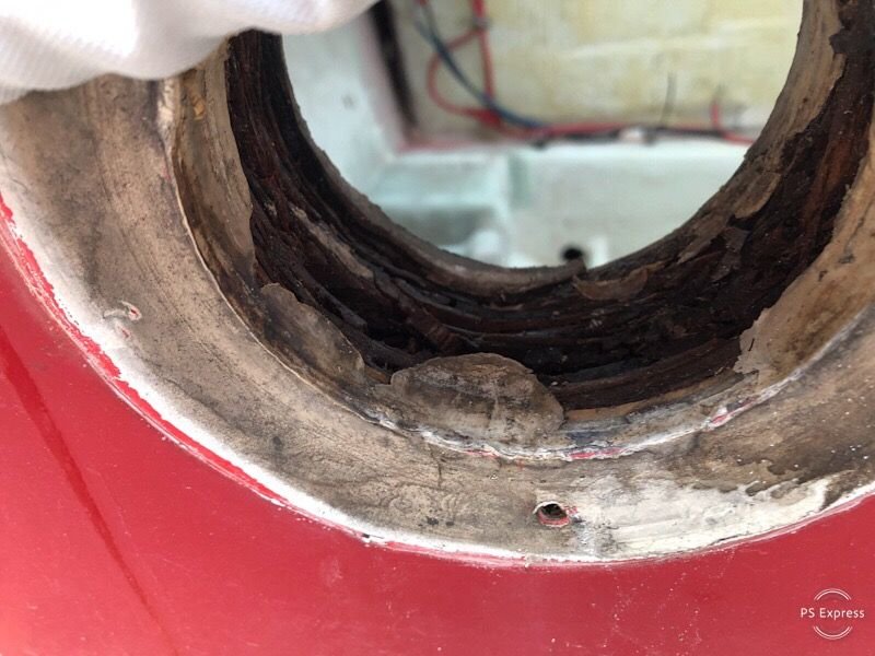

Port putter most exhaust port Scarab Panther

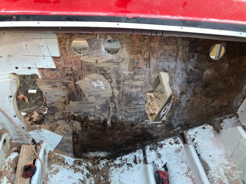

Transome on a Scarab Panther . You can see the water migration from the port exhaust
Center stringer where it attaches to the transom

Especially if it is a 30 year old Wellcraft! These things didn't stand a chance with all the exposed wood on the stringers. I thought I bought one with a solid hull, but it gets worse the more I dig. Are you removing the cockpit floor as well?

As I cut into my transome at the bottom and I to the center stringer, water came running out. I would assume my moisture content wins.
The smaller stringers locates on each side on the center , the wood is missing, just some left over strands of what I assume to be cellulose.
I have the wood wood cut and fitted for the transom. Wrestling 3/4 ply into the boat and back out a few times was fun. I then coated them with epoxy with a slow hardener to let it soak in.

I did my 89 Panther. Transom, stringers up to the helm. Lot of work, but came out great!!
