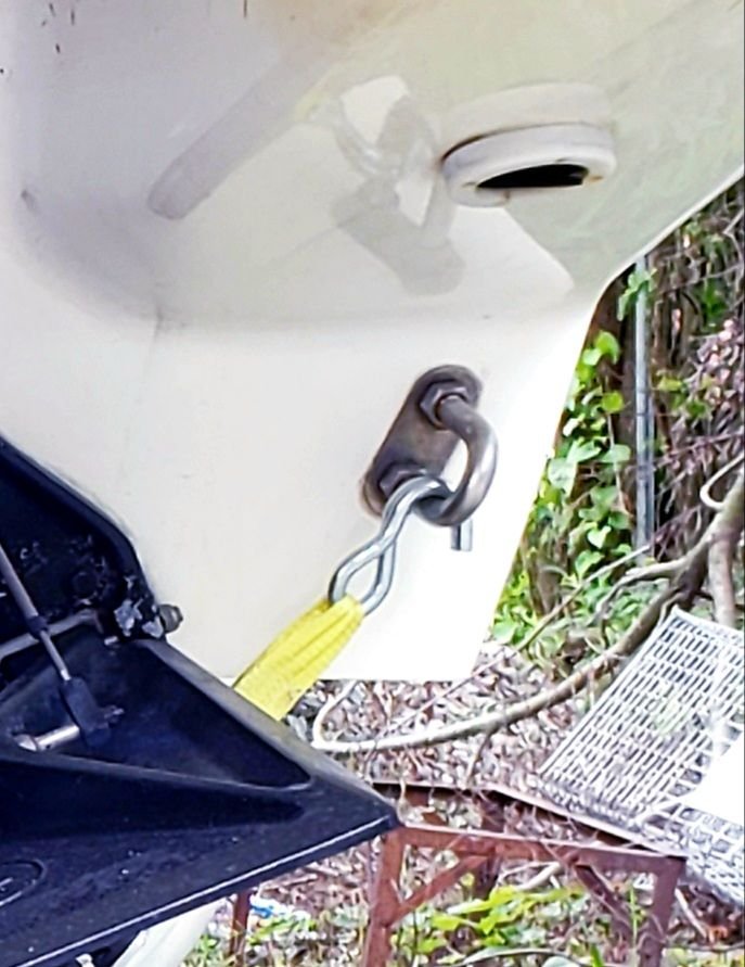

If you go through the posts om this you will learn about the Viper hull changes. The most significant was the change in 2000 where they cut the hull depth towards the rear of the boat. The easy way to tell if you have the old or new design is by looking at the tie down u bolts on the transon. If there is only an inch or so between the bottom of the u bolt and the hull bottom you have the new one. If the distance is closer to two inches you have the old hull. The diff is worth 3 to 5 MPH.
ATTACHED IS A VIEW OF THE OLD HULL

Default This is my 2002 vyper so its the new hull your pic seems identical?
