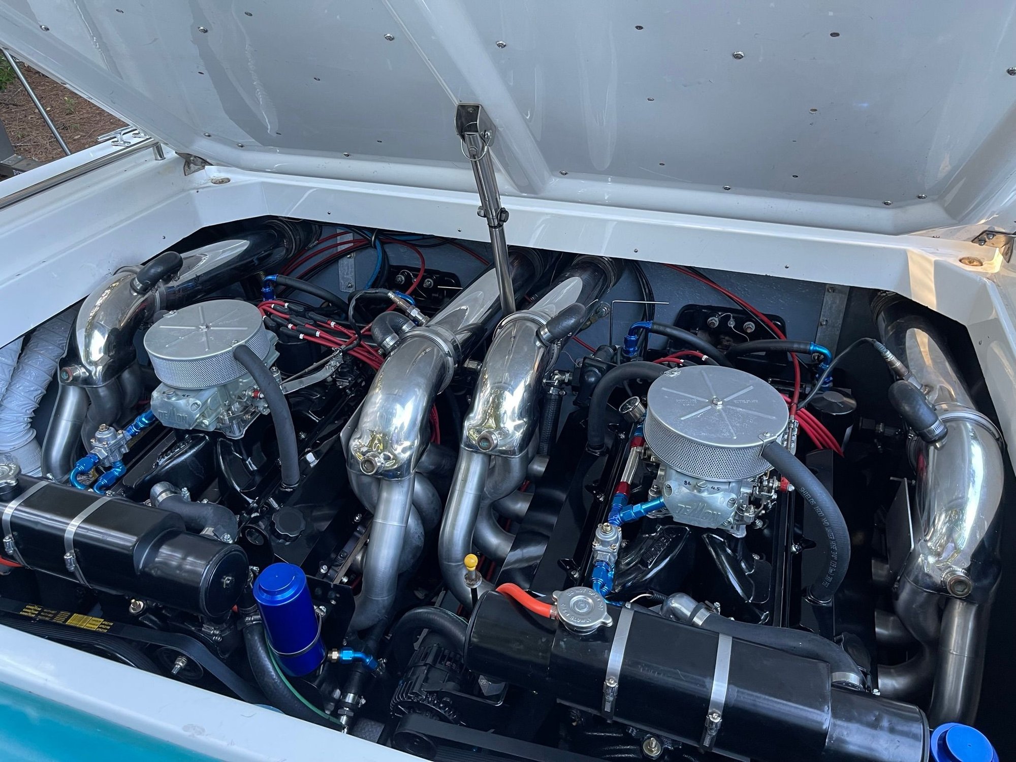

I did the distilled water route when I converted mine. Several flush cycles, but my motors were relatively clean.
I hear you on the astetics, but I got used to it quickly....
seafordguy is offline
Can't tell, but are you running a full system?.....how much hp are you cooling?......is that a Harden closed cooling system?......not an eyesore, looks pretty good!
That's a half system. It's the CP performance kit (which I think is the same as the Hardin). FYI their system fits both standard decks and tall decks (mine are tall decks, and they mocked it up in their shop to confirm it fit before they shipped it). I'm cooling 800 HP. I have never seen the temps budge off 150* even when oil temps have gotten to 220-230 in 100 degree heat.
I was REALLY upset about disrupting the looks of the front of the engine but got over it instantly and will say it was the BEST money I have ever spent on upgrades. It's nice to have them mounted on the engine - if you have to yank the motors out it's one less thing to deal with and just comes out as a unit.

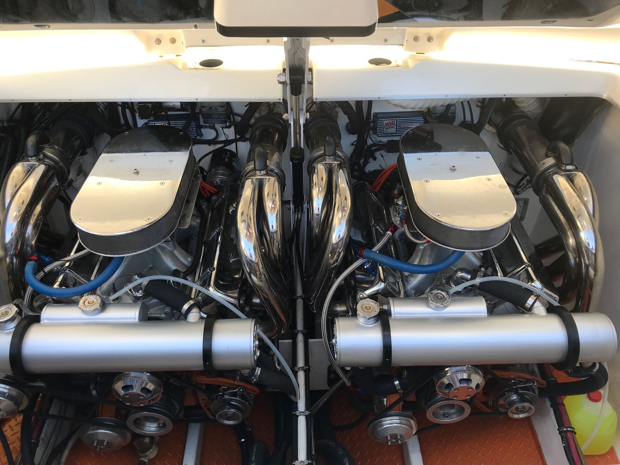

Gen VI 502s… I scraped the insides and tapped on the blocks for a couple weeks while cleaning and taking measurements. Then I prayed that the blocks would pass a porosity test (they did). Easily 3/4 off, to a gallon of scale and rusty chips/flakes and then I washed them with purple power and vinegar. Finally, the blocks were pressure cleaned and tanked.
Crap still ran out of them at the first start up.
I drained the systems after that, and once in the boat, they were filled and have been fine since.
Flush flush flush and flush again. And then flush some more.

These are Merc 454/502 heat exchangers on my 509s. Running 600+ and the temps drop into the 150 range at speed. I got mine from Mike, too.
