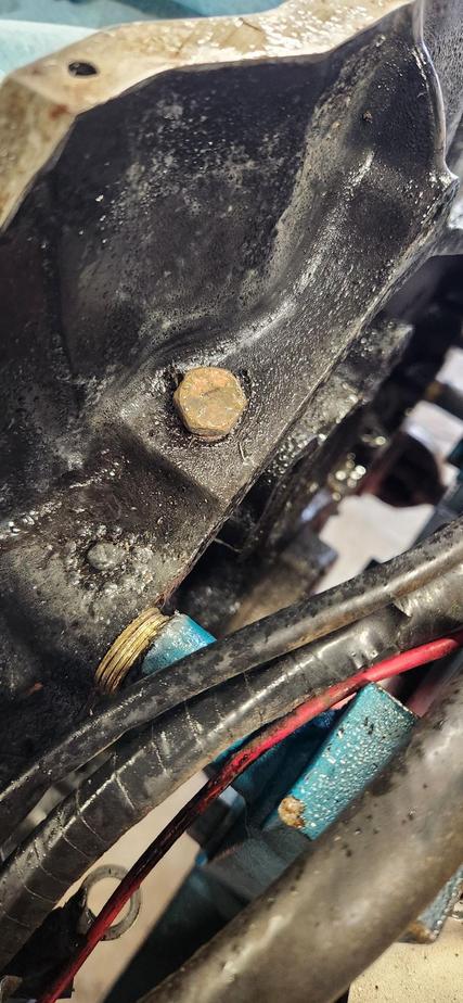

Also can I use either one of these locations for the oil temp sensor? See below.
Is this an oil port?
Is this an oil port? ^^^
Not exactly sure what side the plug is on ie, to engine or from cooler.

The top pic I'm pretty sure is where a pressure sending unit would go. Not sure that's a good location for getting an accurate temp reading. That port on the oil filter block should work fine. Trace the hose back to verify that the oil is running from the block directly to that filter location. That should be the hottest oil.
