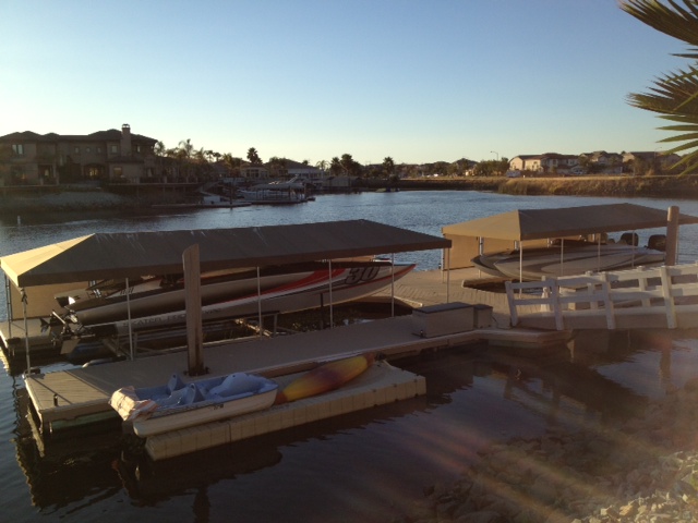

Since this came up in a different thread recently (and I've always just been curious), do any of you guys keep your Skaters on floating lifts such as Hydrohoists? Both my inboard 30 and my outboard 28 stay down at my docks on centermount hydrohoists, making it very easy to measure the CG of each boat. Once you have the boats out of the water and the lift is sitting perfectly level, the measurement from the transom to the center of the floats on the lift gives you the center of gravity of your boat. With very little fuel in each of my Skaters, the measurement to the CG point on my 30 is 80" - which equals 21.74% of the length of the boat forward of the transom. The 28 measurement is 68" - which equals 20.24% of the length of the boat forward of the transom. The higher the percentage #, the further forward the CG is and the better the boat will run in the rough. I've done everything I can (without ADDING weight) on each of my boats to get the CG further forward for better rough water handling, being that they're both smaller Skaters. I'm curious as to what your guy's Skater's CGs are? Please list model length and motors/drives - my 28 has 3.2XSs on 6" brackets and my 30 has Sterling NA 588s w/ ASD7s.

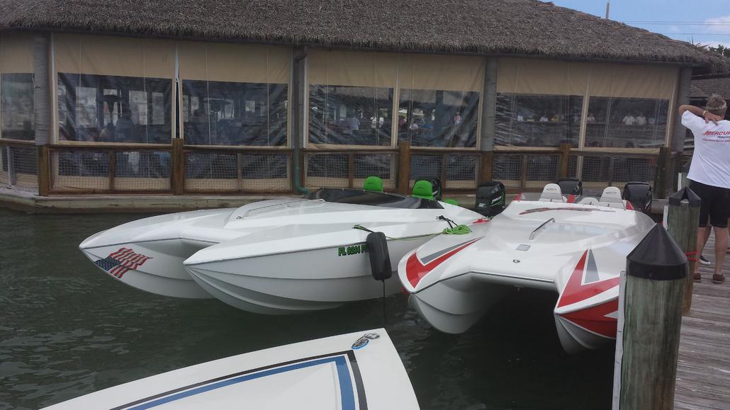

[ATTACH=CONFIG]528779[/ATTACH]I
would love to know where mine is but I do know that I agree 100 percent on the further forward the better. A properly set up 28 is blast in the rough water. We do it all the time down here!

I'd bet that the CG of your 32 is very similar to that of my 30. My 588s weigh about the same as your 525s (800#s apiece - I weighed them at Skater), our drives weigh about the same (just over 300#s for both a complete Bravo 1 or ASD7) and I am also on driveshafts very similar in lengths to yours. I was VERY aware of CG when my 30 was being built, as I run in some pretty big waters at times in the Pacific Ocean.
Skater30 is offline
