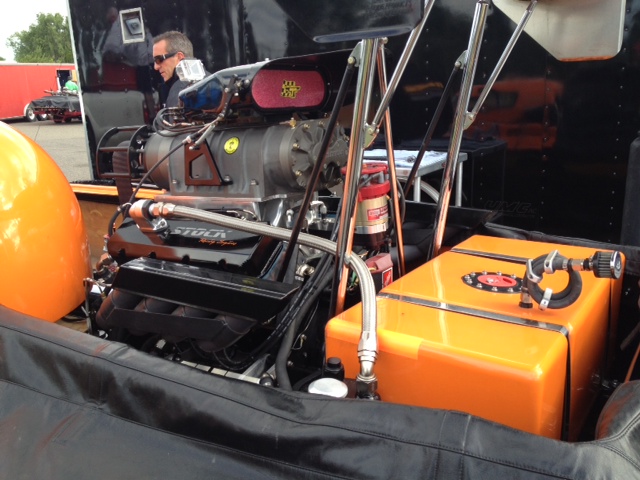

You're obviously way more technically knowledgeable than I am on this subject David, but I can almost guarantee you're not going to see any true "ram-air" benefits in performance. First of all, the cowls are not sealed, which would be necessary to provide true "ram-air" induction to the throttle bore. They have vents/drains in other areas of the cowl that allow air to escape, negating true "ram-air" effect. And if you rigged a sealed tube from the air intake to the throttle bore for true "ram-air" intake, you'd be risking ingestion of water if you ever took spray into the intakes (which does happen). As an example, we run the injector hats backwards on the K-boats we race out here in California so as to not injest water spray from other boats. When we go to try and set a kilo record, we don't turn the hat around to face forwards, as they go just as fast with the hats facing backwards, even though there's 140+ mph ram-air right into the butterflies when facing forwards! And, I can tell you from 15 years of experience with 28s that these rigs take more than small gains of 3-5hp per engine to even be noticeable on the speedo head, or in the seat of your pants. I do really like your enthusiasm and detailed knowledge of performance equipment though! Let us all know how she runs..........
Attached Thumbnails Nass cowls - the effect of ram air-11.jpeg   Nass cowls - the effect of ram air-115.jpeg   Nass cowls - the effect of ram air-img_0288.jpg
