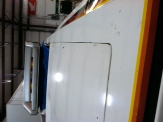

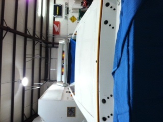

Got to do a little fitting up last night for the race hatch to permanant hatch conversion. The race hatch fits surprisingly snug, so I will need to do a little "reduction" so it dosnt mar the new finishes on the rare occasion it will be installed.
The race hatch will be cut to 24-30 inches (havent decided yet) to provide a permanent rear hatch to bring this hull to a newer look, and move the rear seat forward. I have also figured out a way to salvage the usability of the front portion of the hatch so that the rear seat can be removed and the front section of the race hatch can still be installed for giggles if need be. A couple of simple stainless brackets should work fine for front hatch attachment.
The rear bench in the pic will also be brought into the 21st century after mock-up.
Parts are still flowing in, but more to order after Christmas.

I cut my race hatch and moved the rear seat up also. I used a electric screw jack to avoid the need for the pins. Plus the hatch can not be opened unless you know where the switch is. So I turn off the batteries, close the hatch, and it is the theft deterrent. I have only off/on ignition switches, no keys. The screw jack holds the hatch very tight against the rear seat, no vibration. No pins to scratch the boat or lose
I might have the old factory pins if you need them.
