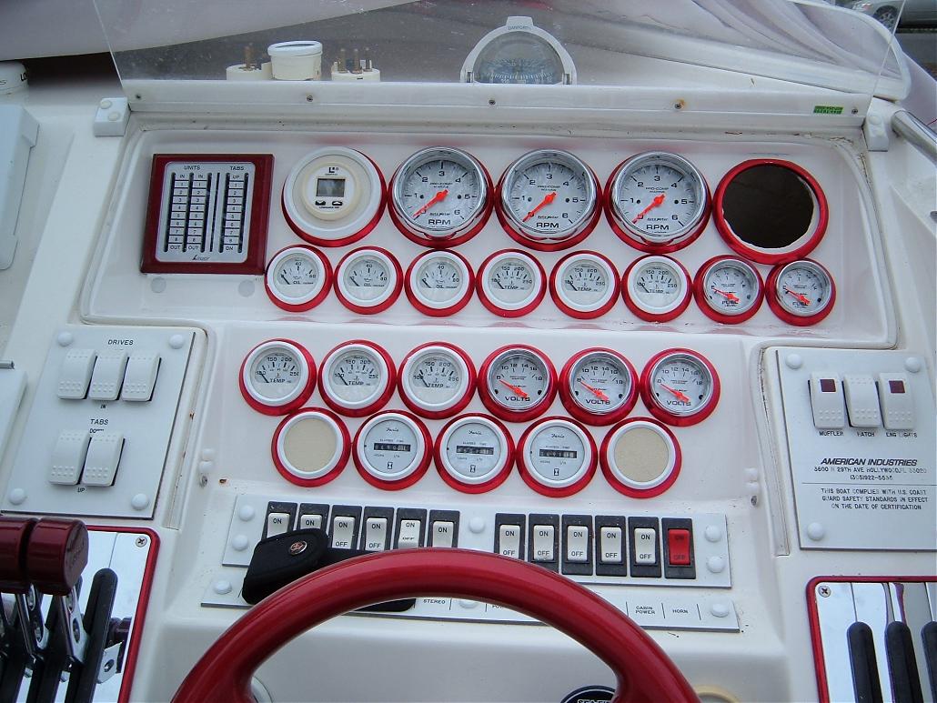

We have been using a tinting process with paint and clear to do dash plates and panels. Find me a color blue you like, send me the panel and we can make it happen for you. We did this on our Sonic switch plates in red and they came out great.
Attached Thumbnails External GPS Speedo-process.jpg   External GPS Speedo-almostdonedash.jpg
