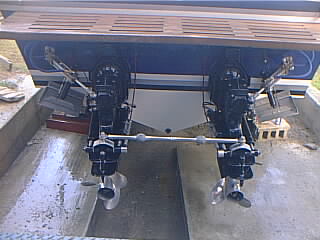

Dyno, I installed a system last year. Here is a pic

Dyno,
The IMCO steering rams mount to the inside in a factory installation for the 31.

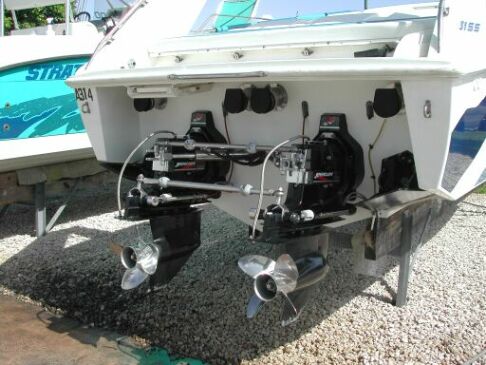

Dyno
I just installed one on my 33rs....its by Hynautic and the rams mount on the outside

does it matter???it looks as if you can mount them either eay in or outside....I didnt think I would have room going to the outside..

CelticPride, Why the dual tie bar?

Default pic for xcav8
I'll send you a more detailed one via email
I didn't find the web site but I can give you the details of the retailer I purchased from.
Tomba
Trim and Throttle!!!!
