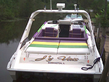

Pics of our 34SS
Our boat club went to New Orleans for the weekend, stayed @ marina and watched LSU smash the Gators! 2nd time out in boat, love the ride. 6 ft. seas on the way home today, no problem! We were very impressed with the ride! Took these b4 we left Sat. morning. Will take some more later.
1990 boat, 525 sc's, bravo 1s. Last owner had the engines, drives, upholstery, dash redone in 1998. Got 74 on GPS, 5400 rpms (3/4 fuel, loaded for weekend trip). Had to hold back, didn't want to turn too much. 5200 is usually max on these engines I think. may need new props? They are 25s, not sure of dia. , will check later.

Great looking boat! I think that my boat is the same model - 1995 35 SS. I had 25 3 blade props on my boat and we ran 67.1 on GPS. When I switched to 24 4 blades (hydromotive), the boat felt MUCH better and it ran 66.7 on GPS. It seemed to come up on top of the water more and it seems to me much more efficient. I only have 454 Mag MPI's. I bet 26 or 28 Hydro 4 blades would work great on your boat.

Very Nice & Clean Sonic ! My brother is looking to get into a 34-35 Sonic. He currently has a 32 Pachanga w/ 454/330's. Very Clean boat with Factory Arch- Very, Very Rare ! Anyone know of one for sale let me know....
