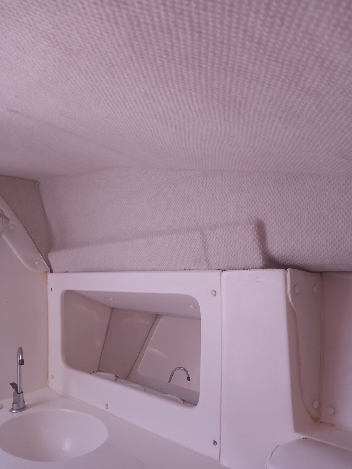

ok, so I bought my boat with the headliner completely gone. I had an upholstery guy come in and do a headliner. After 2 attempts at using foam backed vinyl he gave up and talked me into using hull liner. It came out pretty good except I'm not liking how above the sink looks. Does anybody have a picture of their cabin above the sink so I can figure out how to make it look a little better? Like I said this boat had no headliner in it. So I don't know what it looked like before. I don't know if there is something missing. I do have extra material. Thanks guys.

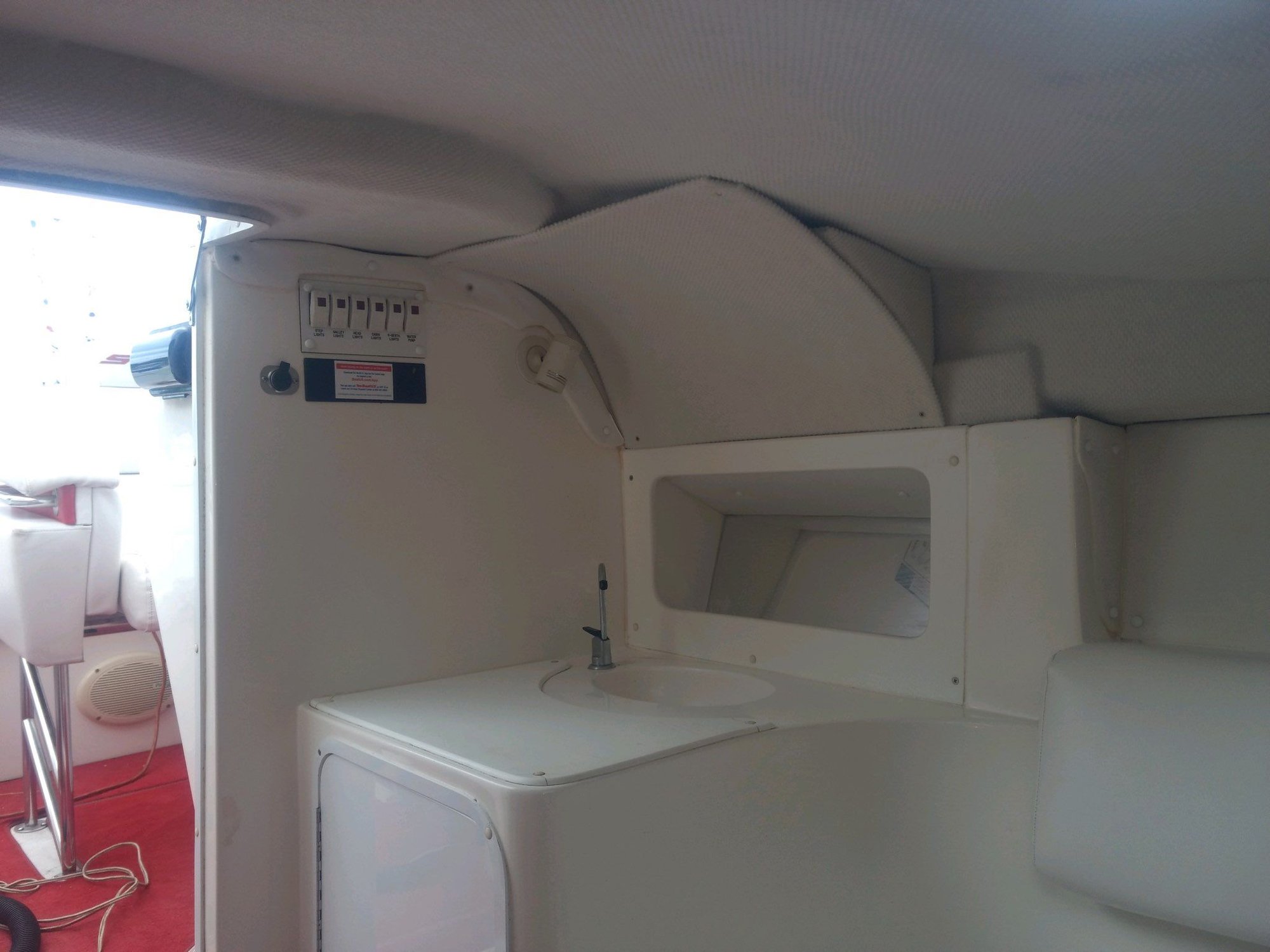

This is my prowler
98 prowler

Just wrapped up the headliner in my 38. Nightmare. I wouldn't use the foam attached to vinyl for this application. If you stick it somewhere, it's there. If you try to move it you will ruin the whole piece. Also difficult to get it stretched tightly and ensure you have no ripples or wrinkles. Separate foam and vinyl is the way to go here. I'm currently trying to come up with a trim solution for the top area instead of a bead of silicone. Open to suggestions....

Seems like they did them a little different on some boats. I see you don't have the trim piece above the switches. We were out in the boat today and I just took off that curved piece. Looks much better. Not as clean as yours though. Thanks for the pic. Another question, where is the sink pump located? I hit the switch and nothing happens.

the pump is in the engine compartment, passengers side, tucked in the gunnel.

For some reason it seems like there all alittle different. I've never seen another prowler run like mine. Don't know if the x - demention is different on mine than other's. This was the best option I put in my boat I think.
