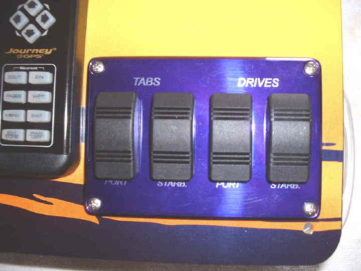

I also needed some rocker switches for the Tabs & Drives. I did not like the idea of having to make rectangular holes exactly the right size for the Carling switches, so.... I found this from Eddie Marine for $80.00 !! It made it so simple.... cut a square hole, drill & tap for four machine screws & DONE!!

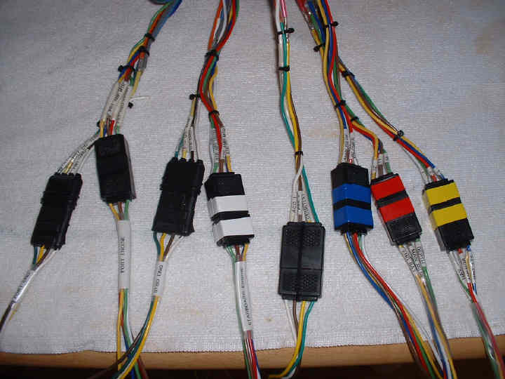

Each switch has a seperate power lead to come from a designated Circuit Breaker for each device operated. And of course, I had to make it easy to remove if needed, so....

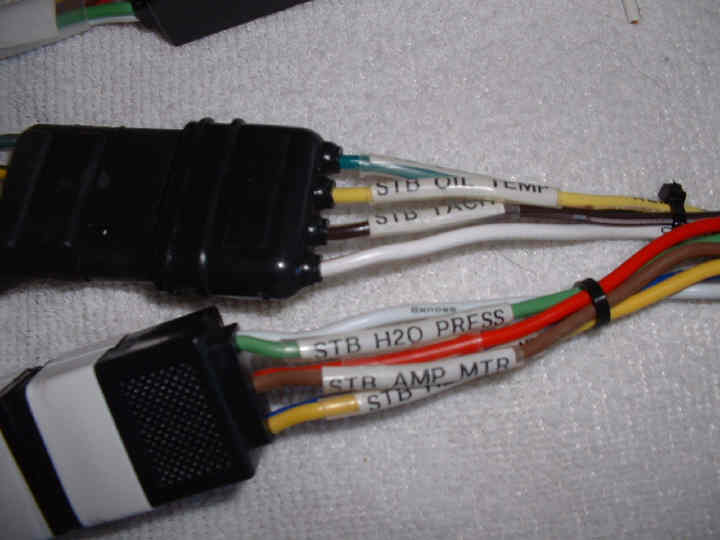

Heavy wiring is not needed as anything with a heavy load uses relays for power. The switches only operate the relays. Now, this is a lot of wiring, so of course I had to label everthing on both ends.
