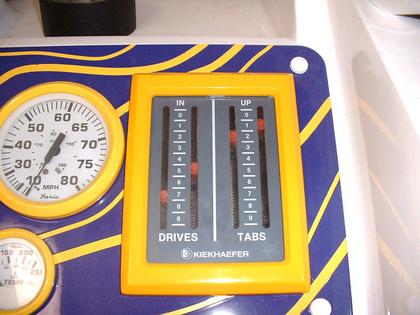

Thanks, Sean & everyone else..... here is the tab/drives indicator that I rebuilt with led back lighting & red pointers.... it did not get attached above.

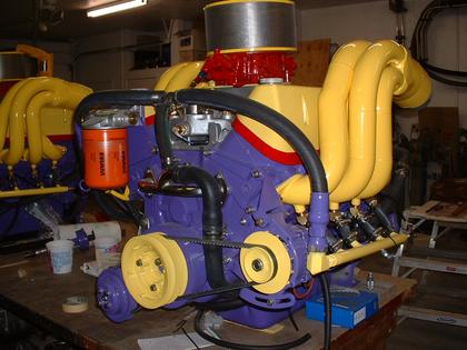

I decided in January to add to the graphics that Fred had on the Sonic, so I took it into "Street Dreams" custom shop... they do beautiful work.... I decided to go ahead with the paint & delivered the boat to them on February 4th...... they wanted 3 weeks to do it. OK>.... it is now nine weeks later & they haven't even finished one side yet!! They are killin' me!!
I still need to install the engines, which have been finished now for 3 months... just waiting the exterior paint work to be done, then in they go, as soon as I cut the new 5 1/2" holes for the exhaust pipes (internal mufflers in dry pipes)... they are wetted but just the last 3 inches!! Then I have to finish the new interior..... it may have to wait for the end of summer for that step!! This boat will be wet this summer!!! Fred's trailer queen has now been dry for over 2 years, between he & I.
Anyway, I thought I would post the new engines to the thread..... remember- what looks BLUE is really PURPLE!! Damned flourescent lamps in the shop changed the picture colors I guess.
