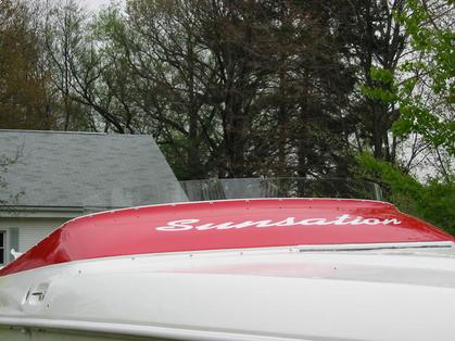

From about 20 feet away, you can't even see that there's lex-an there.
I made it out of 1/4" thick lex-an
6" tall with the last 8" of the end tapered to 5" (for the sporty look) That leaves about a total of 4" above the fairing.
I had two test pieces on last Saturday when I went out for my 82 MPH run, and they worked fantastic!!!! My partner lit a Cigarette at 50 MPH without ducking down in the seat!!
The flex in the lex-an was not detectable at those speeds, It's a rock solid system. We then took them off to compare the feel of the wind, but that lasted till I hit 30 MPH!!!and we stopped and put them back on!!! it was only 57° that day, and it felt like 30° without the screen. But with them on we went for a good 2 hr cruise.

Here I just have the lex-an resting on the engine hatch so you can see them a little better. Mom is making up some slip in sleeves to protect the lex-an when not in use. Arn't mom's great
