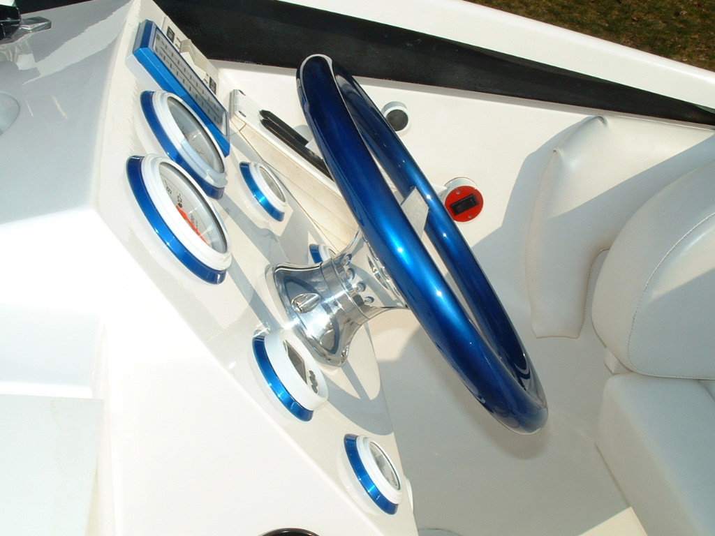

Is there any downside to putting in a tilt helm and all internal hydraulics before putting on a single or dual ram? I would go dual, but because of cost I will probably piece the system together and would like to start with the internals....
Please let me know.
Please let me know.
Until you install the external stuff, you can't install the internal helm. Well, maybe, the new helm I got to connect to my hydraulic helm wasn't compatible with my stock cable helm. I would just bite the bullet and get a FULL system. The tilt helm units add quite a bit to the price of the system. I don't think they are necessary. On my 24, the wheel is at a good angle.

Dave M,
In your picture, what is your throttle mounted to? Mine is flat against the helm, I would like to angle them some.

Originally Posted by RazorsEdge
Dave M,
There is a wedge between the contols and the dash. It is made out of starboard. It was like that when I got the boat. I was actually thinking of getting the throttle pod for my controls and then putting a switch panel where the controls are now.
