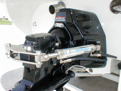

What would I have to modify on the drive lines? I figured I would ask. If I am making the switch to hydraulic steering, I thought this looked like a really nice setup. I have not looked into the cost yet.
If I installed a 2" short drive, wouldn't it be hard to get the bow up?
I have the happit of making changes and not doing it the way I should have in the first place, and paying a lot more for the finished product.

If you use an Imco box, the shaft on the drive that goes through the gimble will need to be changed to a longer one; it's part of the Imco kit.
If you use a Stellings box, the coupler on the engine changes and also the shaft from the drive.
I don't think there would be a problem carrying the bow with a 12" extension box and short drive, the drive on the 24s is pretty low to start. With an extension a short drive is the norm; swapping the drive lower is the easy part.

The Mercury ITS Box Is A Real Nice Unit/// Installed One On OH ZONES Boat And I Am Putting One On My New Boat

How much does one of those puppies go for, ITS box ? Like a mini #6 And remember for every 9 inches back equates to 1 inch down .

Oh-Zone's boat was rigged with the ITS from the start and I would highly doubt he would remove it for a comparison.
The numbers from the shoot out with Activator would indicate that Oh-Zone's boat runs about the same as JCjrs old boat with the same power and no extension box.
That ITS system is a real nice clean package though...

I have yet to see any performance gains. I did raise the X 1" so the center of the bullet is 2 3/4" below the lowest part of the hull. Mine had ITS from the get go..... I did the ITS for the clean transome. No seperate steering rams...
