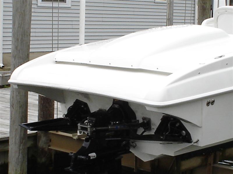

Superbabi's Avatar
Posts: 5,876
From: Toms River, N,J
Default Re: Rigging K-Planes
Well here are where mine are located.
Attached Thumbnails Rigging K-Planes-superbabi...water-006-small-.jpg   Rigging K-Planes-superbabi...water-038-medium-.jpg

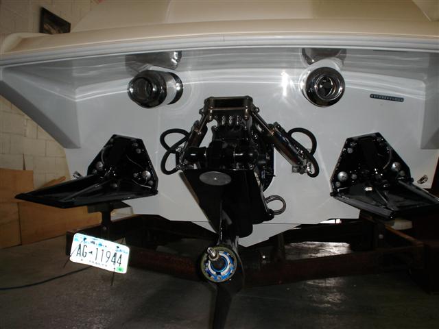

Old 12-18-2005 | 07:11 PM
SUPERSTITIOUS's Avatar
Joined: May 2001
Posts: 2,064
Likes: 136
From: CT
Same as mine
Attached Thumbnails Rigging K-Planes-cimg0084-small-.jpg   Rigging K-Planes-cimg0138-medium-.jpg
SUPERSTITIOUS is offline
Old 12-18-2005 | 08:05 PM
Pat McPherson's Avatar
Joined: Oct 2002
Posts: 5,246
From: Ivoryton, CT
Originally Posted by z.zuperboat
Tabs in my opinion should be as close to the center of the V as possible because when the boats flying on the pad or inner chines the tabs will not have to move alot to be effective. Now horizontal I think would make the boat more stabile for chinewalking and when you hit a turn you have something extra to help carve the turn instead of just sliding.
OK Zuper,
I agree that having the tabs more inboard would have them engage the water sooner when the boat is running high.
I'm still struggling with the horizontal thing though.
I guess with having a notch in the transom, the water is going to come off the boat differently. I don't see it being better on a straight V with no notch.
Also, to your carving vs. sliding comment: I would think having the tabs more toword the keel would help there too. But having them horizontal would have them engage less in a turn then if they were parallel with the bottom.
Hey Lightspeed,
No expert insight for us?
Patrick

Old 12-19-2005 | 10:49 AM
lightspeed's Avatar
Joined: Mar 2004
Posts: 1,948
Likes: 15
From: Cape Coral fl
All I can Tell You Is I Dont Agree Where JC Wanted Me To Put The Tabs .I Have Always Put them 1 Inch Above The Bottom Same Angle As The Bottom And After Running The Boat to see If They Scrubbed Any Speed I Took The Pins Out took The tab Bottoms Off And Reran The Boat No Speed difference Ran The Same. The other way You Have To Put Too Much Tab Down To Contact the water Which Is A No no when Runnin In Big Seas Thats My Two Cents They Will Be 1 Inch Above On My Boat
lightspeed is offline
Old 12-19-2005 | 12:27 PM
Joined: Oct 2002
Posts: 5,246
From: Ivoryton, CT
Hmmm...
So it's all about speed...
The picture is now becoming clearer...
With the tabs mounted horizontal less speed will be scrubbed as they are lowered.
With tabs mounted with the angle of the bottom, and then dropped below neutral, lots of drag is added. With both tabs lowered below neutral they will act together like a parachute.
Hey Light Speed,
I do remember seeing the K-plane mounted horizontal on two Kryptonites. Is that the norm from the factory?
Patrick
Pat McPherson is offline
