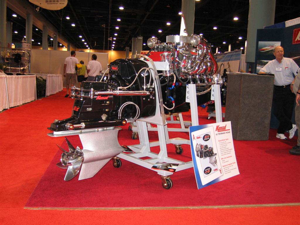

If you are already thinking of HP upgrades, maybe go w/ the Konrad ACE system. Has the external steering built in and can take much more HP than a bravoXR. Comes w/ extension box.
Just my $0.02.
Konrad ACE

That Konrad system looks like a great unit. Do you think parts replacement will be an issue?
The Konrad is a great drive. But as for parts/repair, I would stick with Merc here on the East coast . I have yet to see a Konrad dealer.
Ocean Performance here in Old Saybrook, CT is a Konrad dealer. I saw a nice display on their showroom floor last week.
The Bravo X drive that comes with the 496 HO is good for over 500HP and you can always upgrade to an XR if you build a 600-650HP engine.
IMO the extra $$ for a Konrad is not necessary unless you're planning for 700+HP.

Pat, how much $ is an ACE Package?
How much for a Bravo, and for External steering?
Or an XR w/ its?
all i can think of is everyone here scared of bravos w/ big HP.
And it seems all the Y2K guys are looking at 800+ hp.
I just thought if it was a bit more for an ACE than BravoX + ext steering, it would be a good more for future HP.
Just trying to figure out the $ differences.
