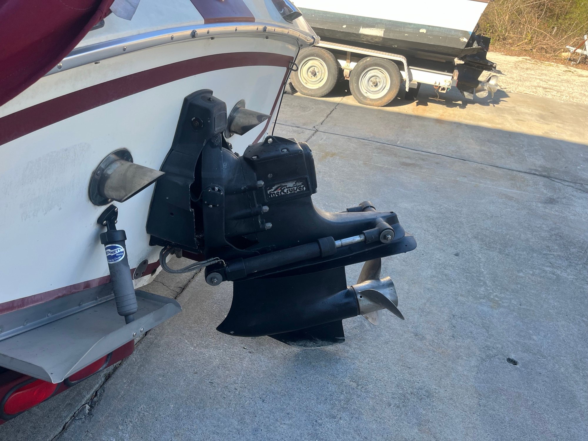

I have twin ram Imco hydraulic steering ready to go except I need one of their back cap mounts, Thanks for the suggestion. I have some 280kplanes as well. I am going to have to fill in some screw holes and regel the transom.

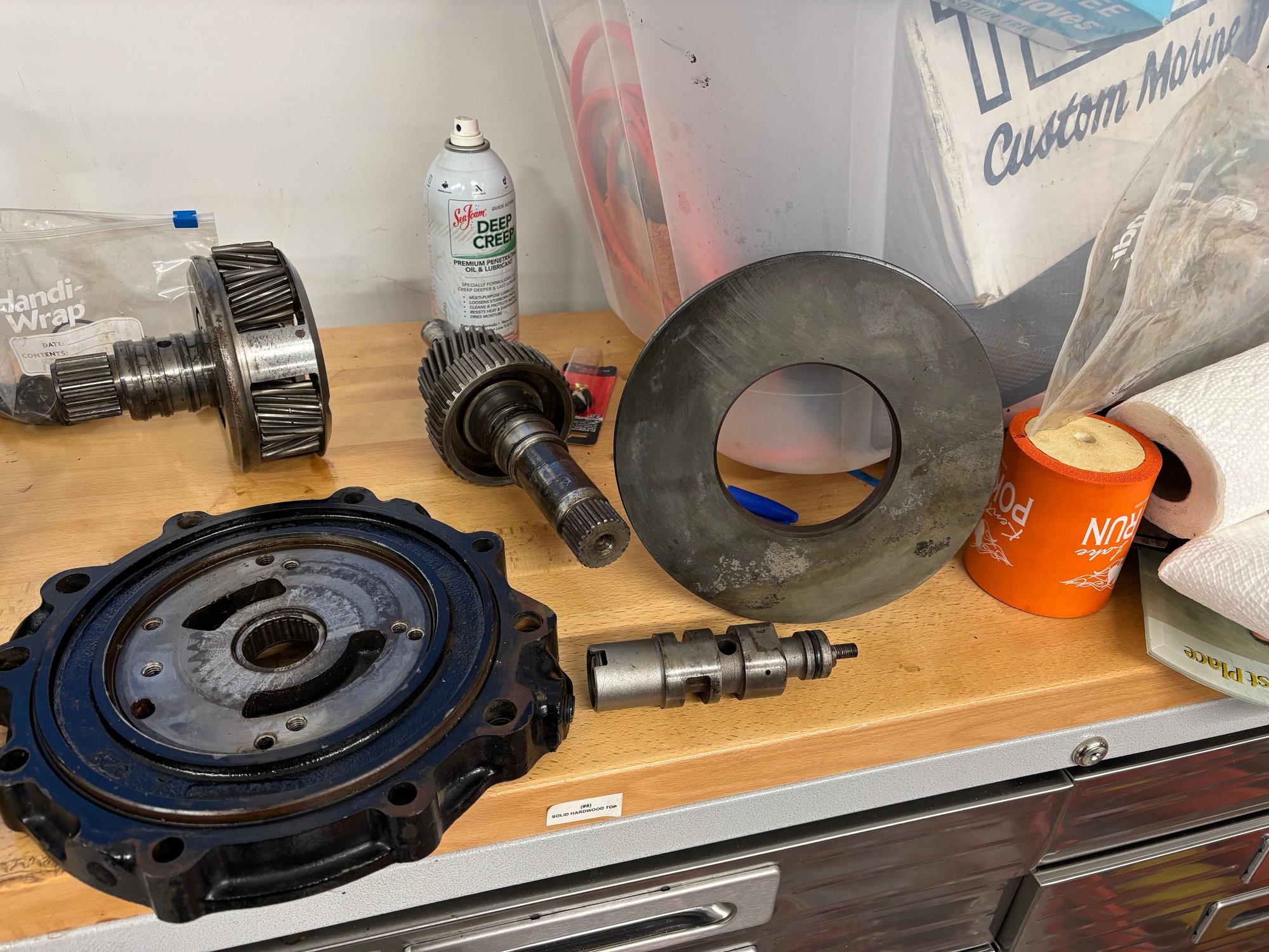

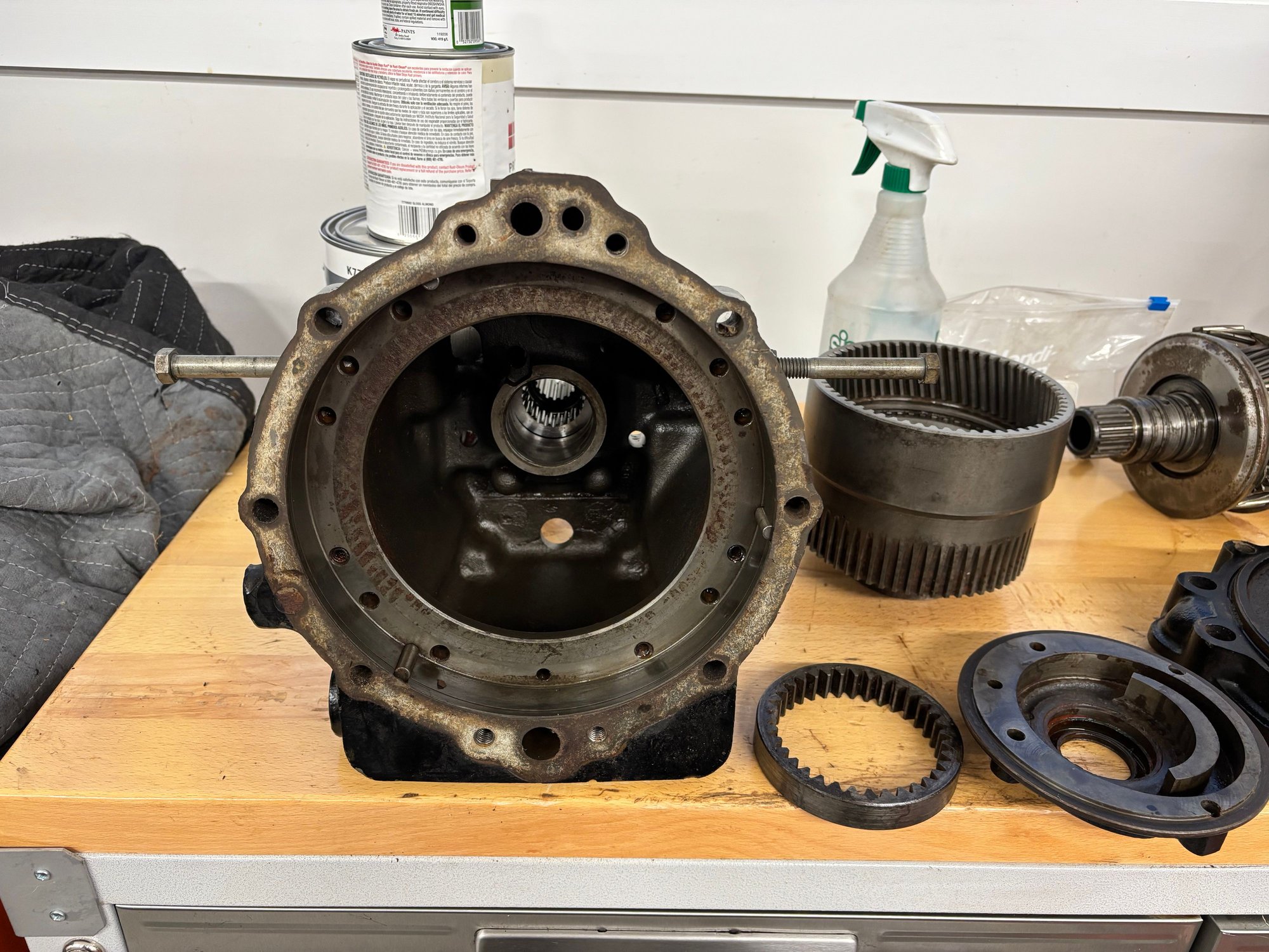

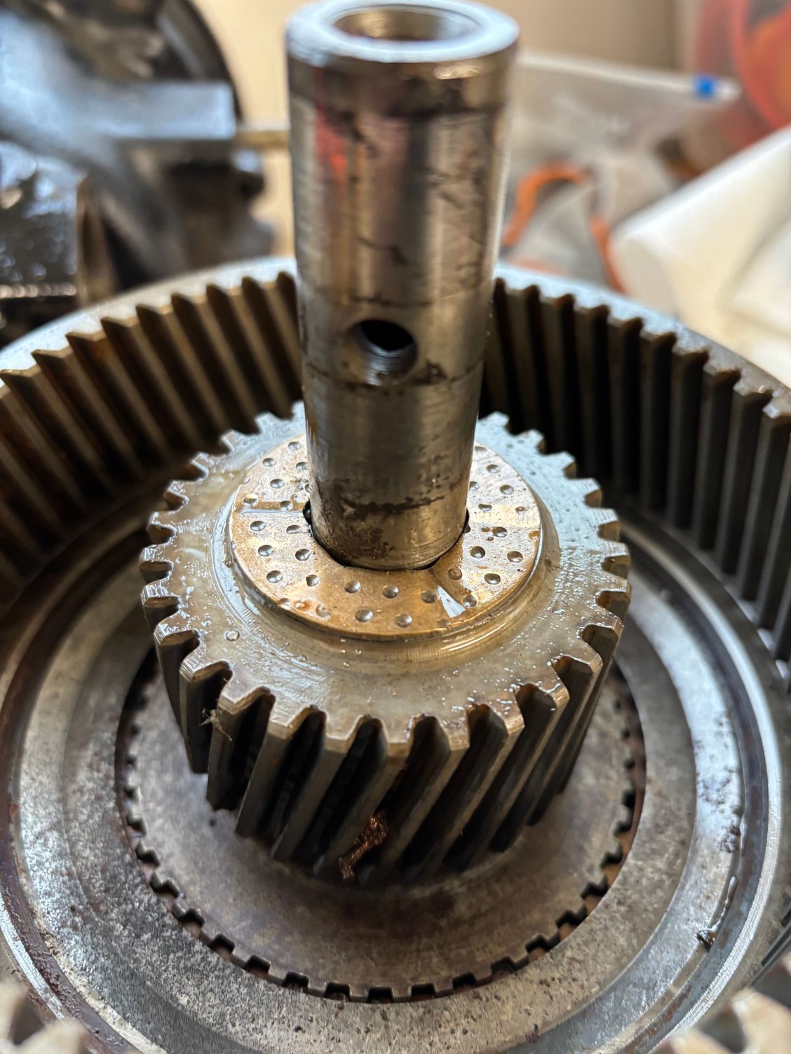

I tore into the 71-c velvet drive this weekend. The used unit I bought had some water in it and it is marginally rebuildable. I was lucky enough to find a 72 that was working but had a seal leaking. So it looks like I will rebuilding that one. I had never opened a velvet drive up. Wow beefy units. Much better than the Bravos cone clutch but they add a lot of weight and have to have a lot of parasitic power loss.

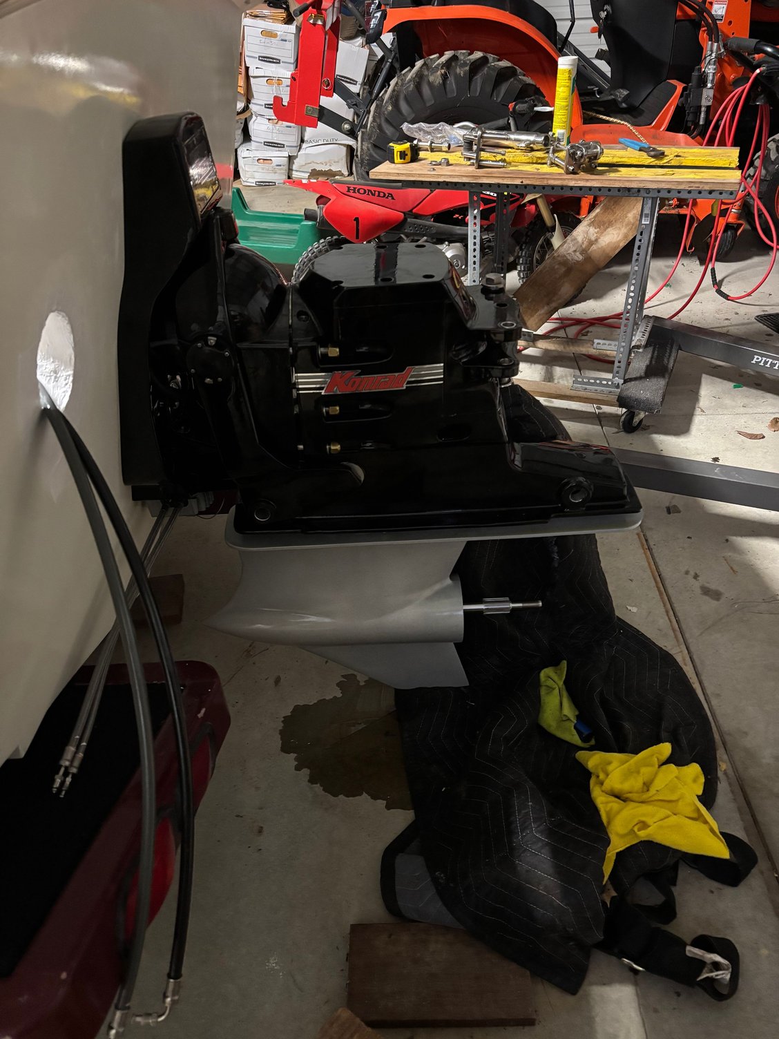

Making progress.
i have all the holes in the bilge area filled and it sanded ready for new coat of gelcoat.

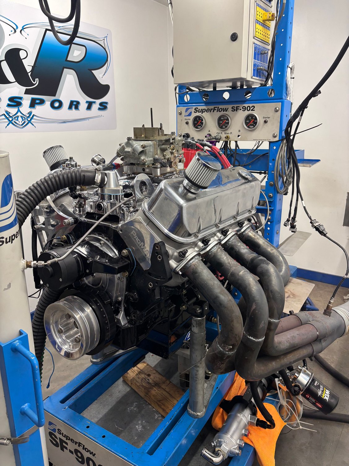

i dynoed the engine and it’s ready to go.

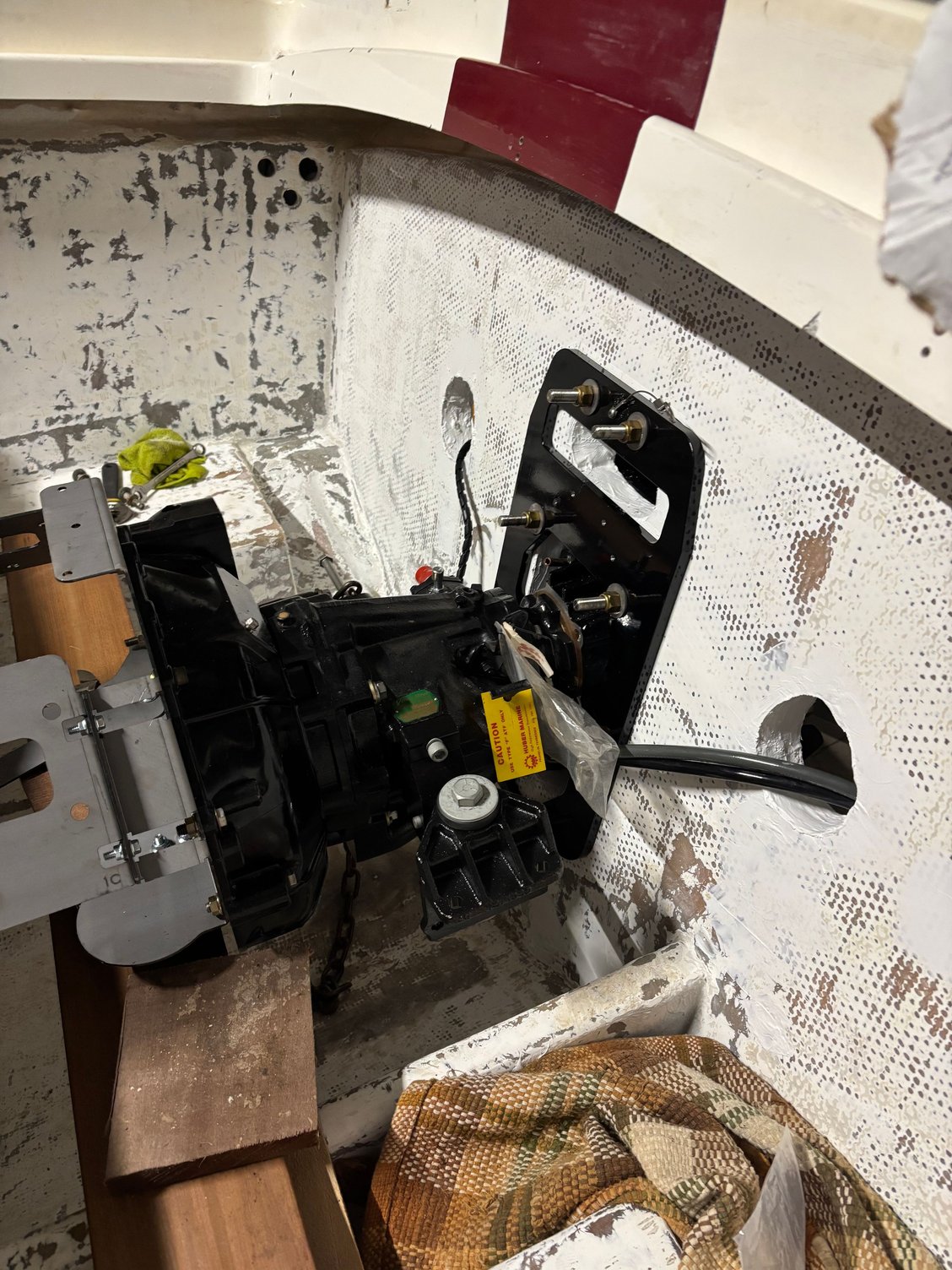

I got a mock up block and I’m fabricating the motor mounts and getting them installed.

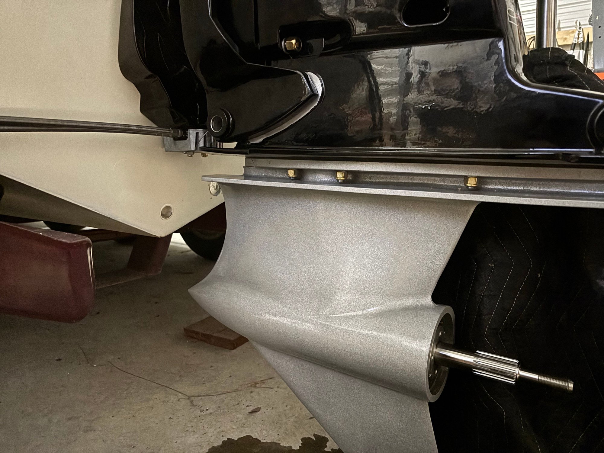

As you can see I ditched the TRS stuff for the Konrad drive with a Huber 1050 drive.
I refinished some 280 K planes and have IMCO dual ram steering ready to go.
SkiDoc is offline

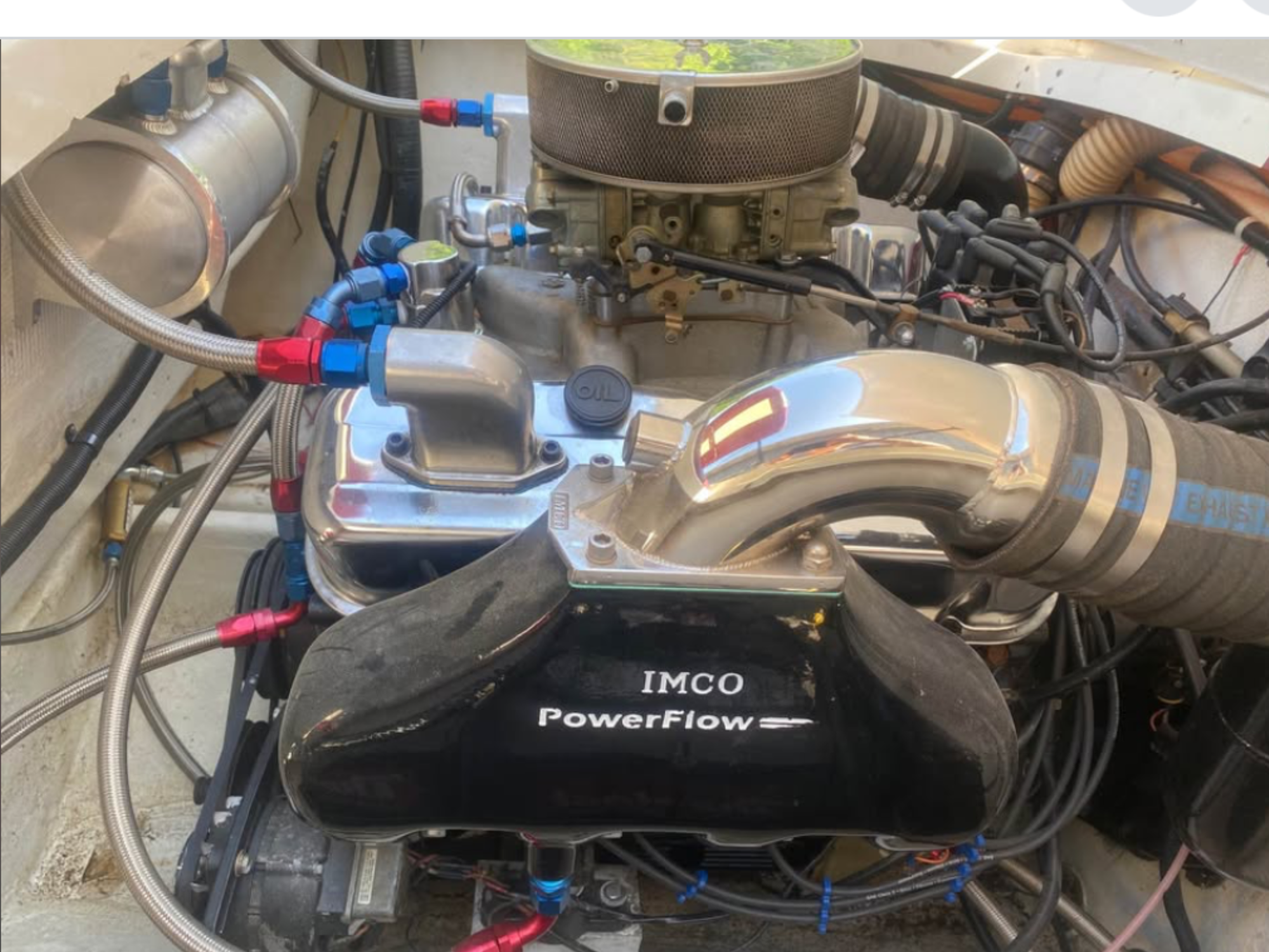

Are you keeping the Imco powerflows?......love the old skool 24' SB's ~ Good luck !
