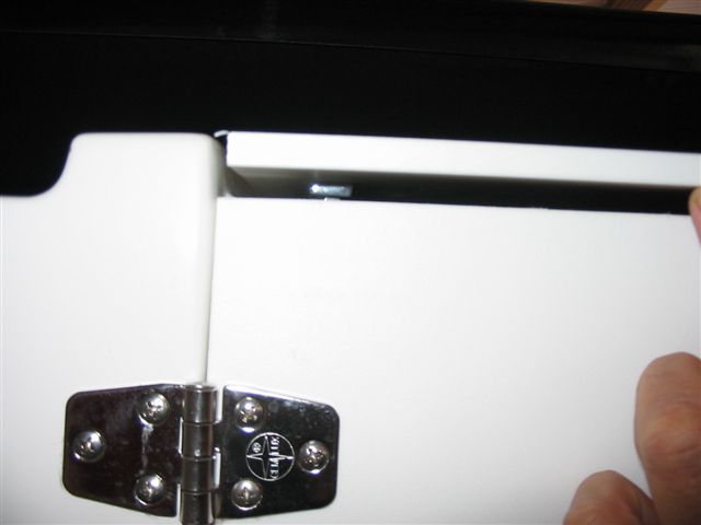

Yeah, I "measured twice". My jamb thickness is 3/4". Will probably have to router to fit, inside and out. Grab bars are a must, especially after sitting in the back of 21's. You can just get your arm behind the rear seat to tighten up the nuts. (I/O's are probably easier). Oh, like I said, I had to buy two new hatch supports (so they matched). My original(should match yours) you can have N/C . I"ll mail it to you. PM me your address. Any new Top Speeds to report? This is still my best. I went down with the motor hole mounting, and it's perfect. No prop slip, no losing prop bite, and can trim the shi* out of it to get the bow up there. My experience with all SUPERBOATS I have ever set up is that they like bow lift to run fast. The more you are able to trim 'em without prop slip, the faster they run.

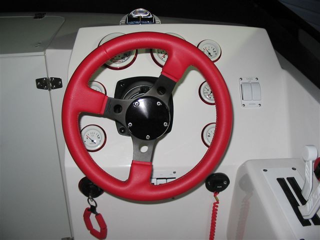

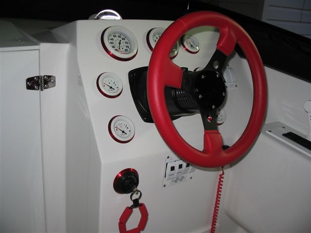

- Just got done adding a Voltmeter to dash, and relocated the ignition switch below it. 2 1/8 hole sawed it. Next is the 3/4" hatch lid, and last, mounting the stereo deck. I wanna mount it in the cabin somewhere behind the dash. Any pics or suggestions on antenna location from anyone?

If you put your stereo inside you will want a remote.
I bought a stick on antenna meant for the inside of a wind shield. Stuck it to the wind screen; it works ok...
