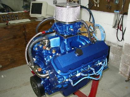

Whatcha got there Plot? How many ponies ? PM me.. You should have sold me your 28 Pant.
