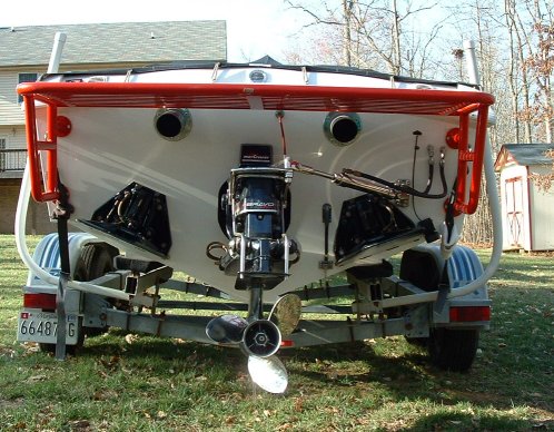

Can you post a pics of you steering setup. I'm probably switching to a dual ram setup and need some dimensions. I want my rams to attach inside of my k-planes if possible. I don't care for the way mine is rigged now. I think my tabs may be closer to the center than yours.
I may have a single ram add-on system for sale if anybody is interested.

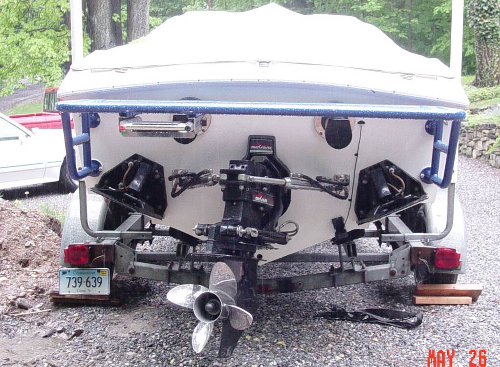

Here you are Dave...

Dave I Just Did Mine.instead Of Buying New Rams I Used The Ones I Had And Moved The Tabs Out.if You Have To Buy Rams Anyway Buy Short Ones So They Fit Inside The Tabs.like The One John Jr Has On The Race Boat.also If Your Buying Brackets They Make Ones With Lines In Them.looks Much Nicer.remember You Need To Mount Them Even With The Crank Center Line So When You Trim The Drive Up They Dont Both Push In And Blow A Line.

Thanks Mike,
I really don't want to move my tabs. If it comes to that I wil live with them mounted outside the tabs. I wonder if John mounts the tabs on the step hulls closer to the drive? Maybe I will call SB and try to get some info.

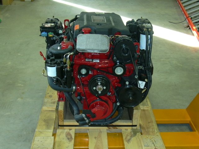

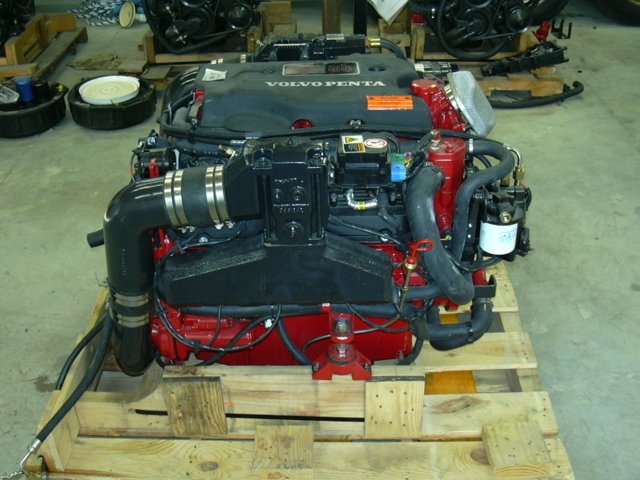

What are you doing with your old engine?
I like your thinking, new with the latest technology.
If you could live with out the warrenty, these can be had for about $5,000 less than a Merc.
