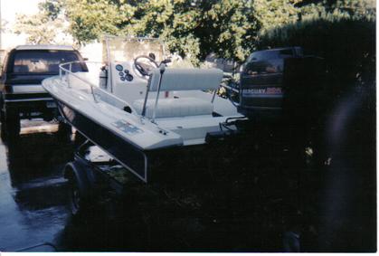

Mine was sweet! I "gave" it away for 2K less motor. They are getting harder to find & I kick myself in the ass for getting rid of it. The 16's believe it or not handle some ruff water & also handle some big power. I had a 200 on it. Now if it only had a pad...
