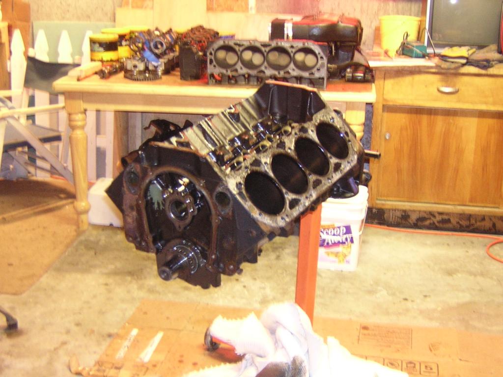

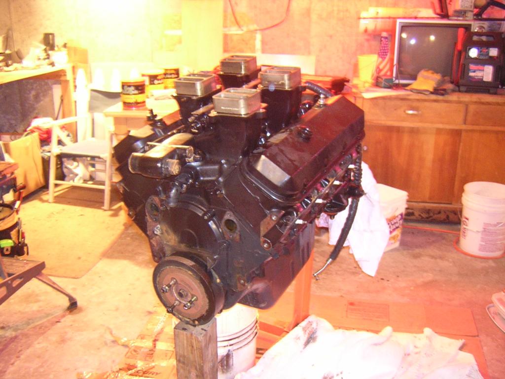

OK guys, seeing Dave's new engine has helped motivate me the last couple of nights.
Attached Thumbnails Let The Projects Begin-502-tear-down-002small.jpg   Let The Projects Begin-502-tear-down-005small.jpg   Let The Projects Begin-502-tear-down-006small.jpg
Patrick
Pat McPherson is offline
Old 01-28-2005 | 10:15 PM
  #37
Pat McPherson's Avatar
Joined: Oct 2002
Posts: 5,246
From: Ivoryton, CT
Default Re: Let The Projects Begin
Hey Engine Gurus,
We pulled this baby out off my buddy's Fountain because the oil pressure seem to be dropping all season...
Then it would not maintain oil pressure at all after a hard run. It showed 30-35psi at 4000+rpm then would drop to below 10 when you pulled the throttle back...
She is just about stripped to the bare block now.
I can't find anything wrong with this engine so far. All the bearings look good; not even one scored surface...
Could it have just been the oil pump bypass???
Tripps, Zup, anyone... Ideas please...
Patrick
