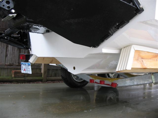

-First two of my 24.
-3rd of 30 Y2K "All Rise".
I would like to comment after all this bowlift talk. Bowlift to me is not wanted in the big ruff water for these hulls. They run FASTER & SMOOTHER level...using the cutting action of the VEE. My TOP SPEED evaluations are for smooth, flat, low chop conditions only. I know these are Offshore style hulls...& really not intended for lake TOP SPEED conditions. As comparison...a 24 Progression has a higher Bow stance when running in normal conditons...making it a faster hull. I would take the 24 SUPERBOAT over the 24 Progression in 4-5's any day.
-You know...the more I look at the 24 & 30....there is only a very slight difference in the two's. The 30 looks like a little "sharper" vee...while the 24 has like that 1" drop before the pad.

Bash,
Since I''ve been back I haven't had the pleasure to build a 24 yet. I must have 40 of them under my belt though. I wasn't sure of the pad in the 24, thats why I asked for the pic. From what I can see, the 24, and 30 have the same pad, if you can call it that.
In my opinion, it's better to have the bow lift to start with. If you don''t have it, it takes alot of power and trim to get the bow up, which can rob you of speed. If the hull has a bow that rides higher, it takes less trim, which theoretically uses less power, and should go faster.
The 24 and 30 share the same bow and deep vee, as you know, the 30 is a stretched 24.
