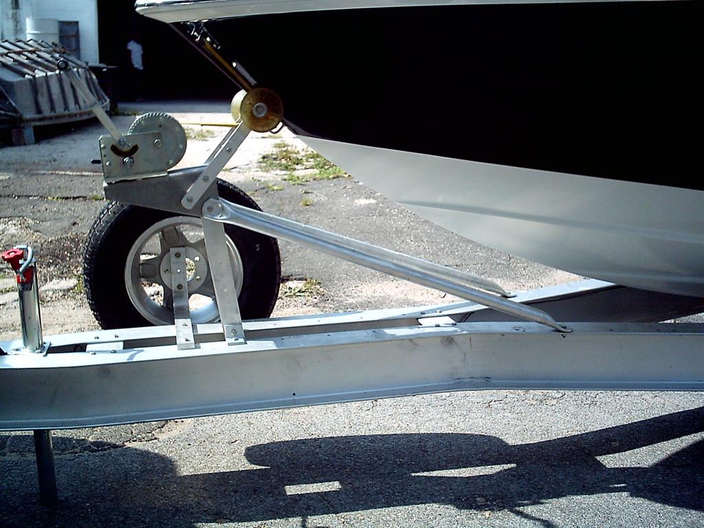

Keith,
I posted this for Tom, but if you didn't read it I hope you get this.
You might want to adjust your winch like the picture I'm putting up. It puts the bow roller right on top of the bow eye. I moved the winch down one hole and the rear supports back one hole. It's much safer this way.

Cool, thanks Rick! I'll check in to this asap. How's the Y2K orders going? More on the way?
