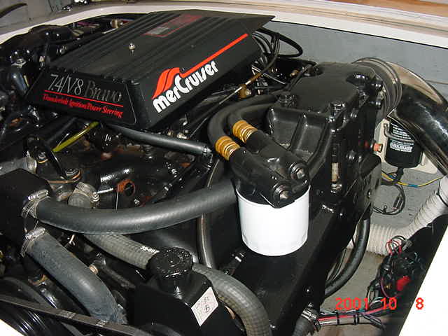

Here are a couple of examples of SBC straight through exhaust.
Attached Thumbnails Exhaust  riser angle-sut20%2520engine-small-.jpg   Exhaust  riser angle-20sutengine1999-small-.jpg
