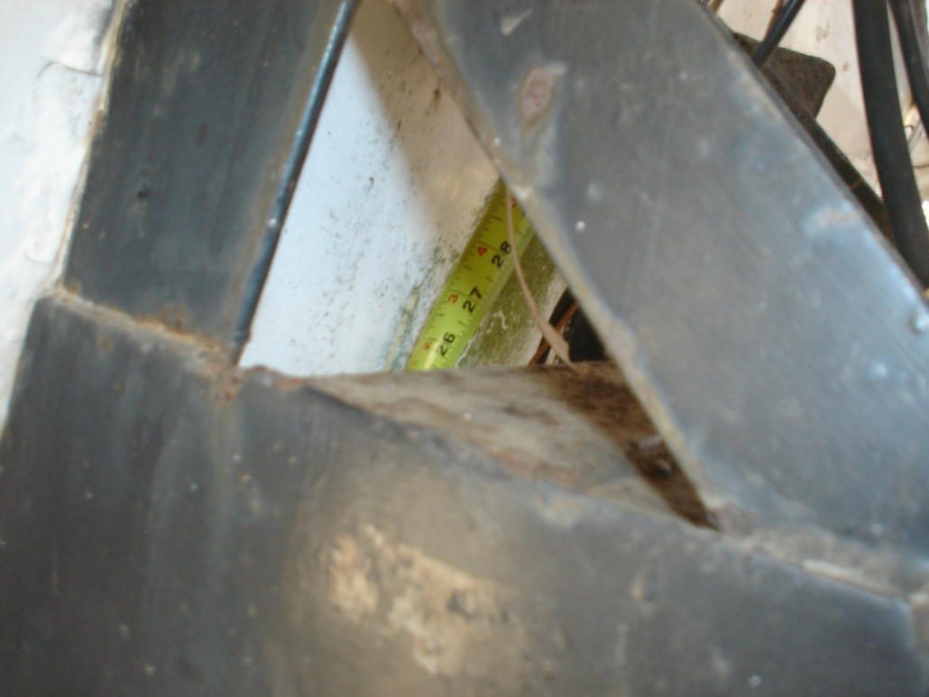

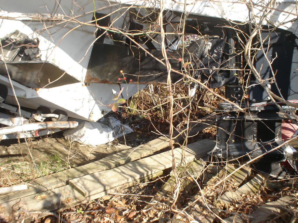

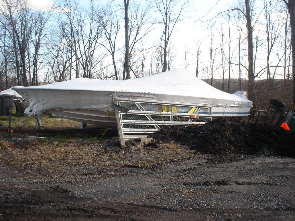

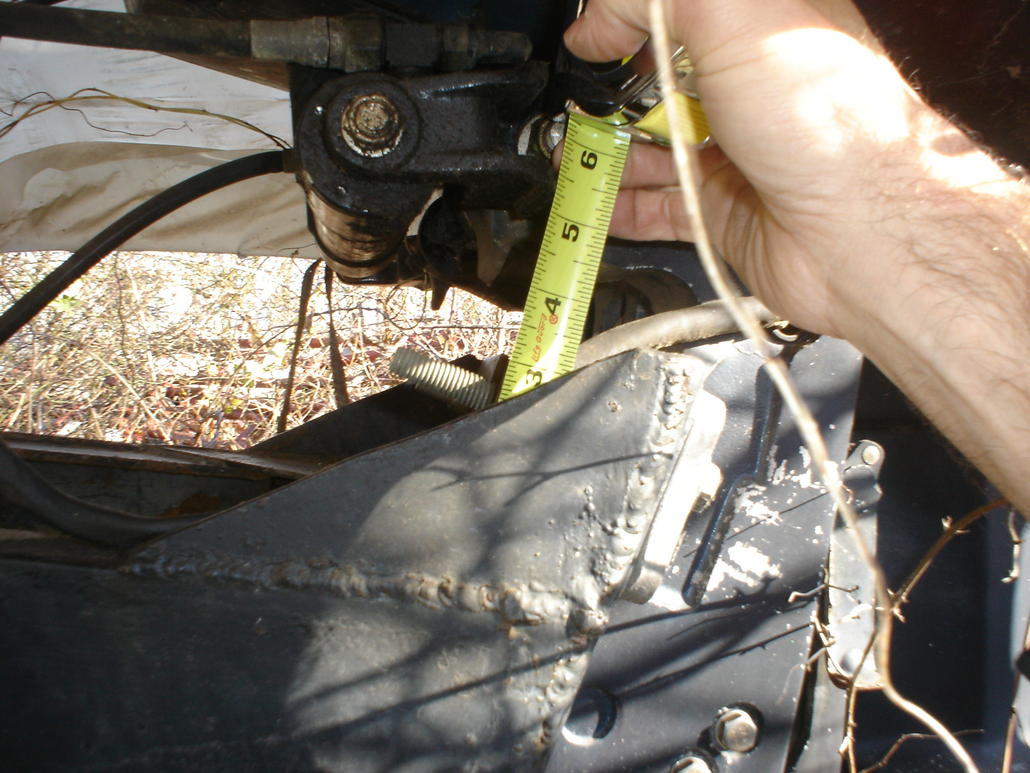

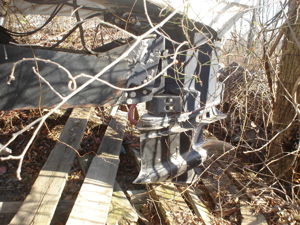

Sound like that bracket is going to force you into the 25" mid. If it wasn't for that I would have definitely run the 20. I looked at a picture of your boat at the dock on page 2 of this thread and that boat sits high in the back with only one engine. Most of those things came with twin SBCs which put a little weight in the back. A full tank of gas won't drop the back of the boat it will drop the whole boat and probably not more than a couple inches. Tanks at about the center of gravity point in that boat.
Anyway I stopped by a friends today who has that 32 Spectra I told you about and took some pictures. This is a contraption we started playing with 25 years ago from an insurance total. Boat was gutted, deck was destroyed, and it started from a striped hull. Homemade deck, engine bracket and 3 different V8s were tried. Engine bracket has 31.5" of setback and engine mounting plate measures 29" top of plate to bottom of boat. First a 25" 275 Evenrude with a best speed of 57. Then we added a CNC manual lift jack for more height and got 59. Then switched to a 85 20" 3.6 300 and got 64. Last engine was a 20" 89 4.0 300 which is still on it and we got 62 out of that. Excuse what it looks like it hasn't been used for about 7 or 8 years. This may look like a pretty crazy idea but I owned it for about 5 years and it was a ton of fun, a definite sleeper. Everybody who saw it for the first time thought it wouldn't even be able to get on plain, (including me) and it took off like a slingshot. The bow never even lifted, you could drop everybody standing and not holding on right to the floor. I had a big cockpit with no front bolsters, just a big bench in the back, we named it Standing Room Only. I used to have like 10 or 12 people in it all the time.
Attachment 433470
Attachment 433471
Attachment 433472
Attachment 433473
Attachment 433474

Thanks for the pics, I need one of those Nose cones you are hiding! lol I sealed up most of the the old through hull fittings today. I had to switch marinas and get my bike ready for the track tomorrow so i had to cut it short. The marina i was at bent my trailer jack so that is another thing i need to address.
My Lower unit upper bearing was disintegrated and i have to finish that saturday. My 25" mid should be welded back up tomorrow also. I might be back in the water monday afternoon.
I am going to set the prop shaft even with the bottom, then i still have two inches of upward adjustment. If i dont lose any performance with the 25" compared to the 20", i wont mind, but if i am losing power because of it, i can swap later, and lower the bracket 5 inches from where it ends up, if i had enough freeboard when full of fuel that is.
I also dont want to set the bracket too low so that trim tabs wont fit if i end up needing them.
I'll keep you updated
JamesGang 12-02-2010 10:50 PM
As George stated earlier, there is no performance difference. Just a matter of geagcase height dial in. If this bracket gives you the desired height than the 25 is fine. I think what he was referring to as an advantage would be as you trim with a 25 as opposed to a 20 you end up with a little extra setback respectively.
