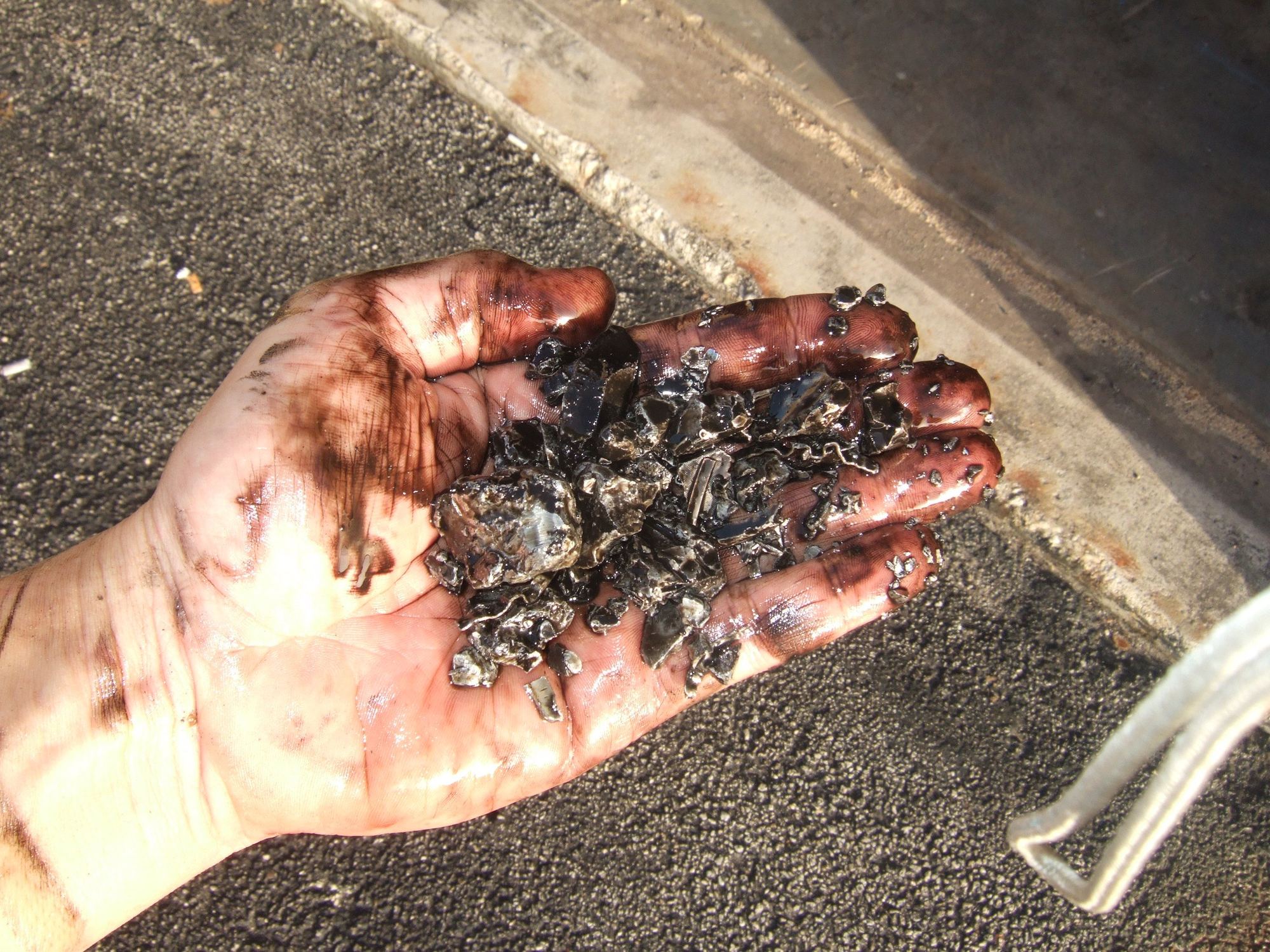

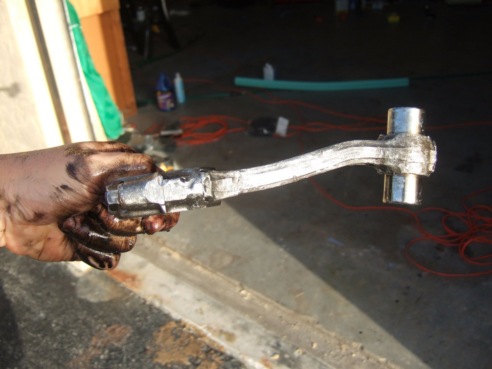

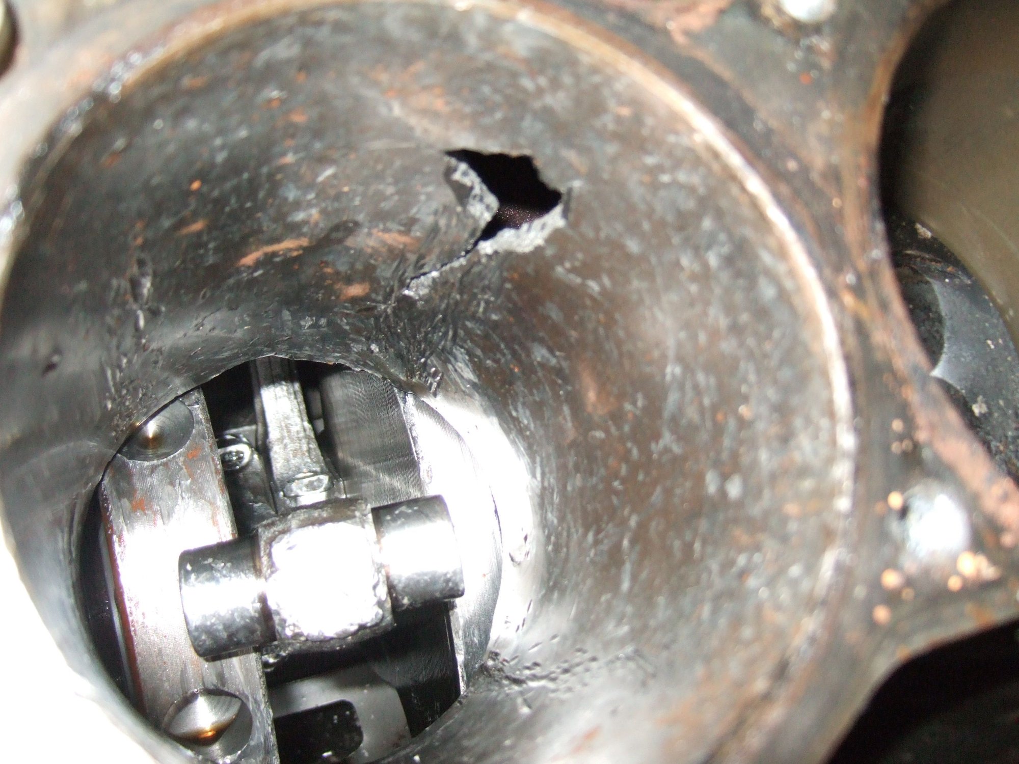

LOL, All forged huh? Thats not accurate. You may want to check serial numbers. Before 2002 theres a "possibility" that the crank was forged, but the pistons are always hypereutectic cast pistons. Otherwise, its a cast crank, and while its not your dads cast crank, its still cast. This is a picture I took to remind myself of how strong 496 Mag HO pistons are. Thats a piston in my hand. The pistons are the weak point. Ive learned this lesson twice....

The stock pistons are not very forgiving to detonation as shown in the pictures.
Kieth,
What were you doing to that poor engine?

Back when the 496s were more popular you couldn’t read two sentences about one before those sh!tty pistons were mentioned. Keith is correct, early HOs were built better but still not consistent, later MYs were not forged.
