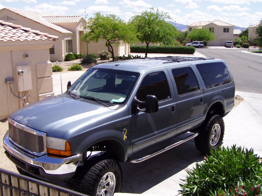

40's on 20's with no lift, mine just must have been made bigger..
(11" of lift with American Spring packs. 12 leaf packs in the front 10 in the rear, not too much sway in it anymore, actually feels safer turning now than it did with the stock mushy springs and shocks it came with. Bilstien gas shocks with reservoirs.

great looking truck
