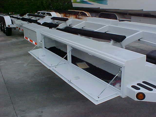

Two spares are a must, and have the both mounted on the trailer with full replacements hubs including bearings and the whole works. This way you have spare everything and can whip on a new hub in moments instead of rebuilding a bearing setup from parts after you've cleaned out the carnage. If you are going with integrated rotor/hubs (depends on brake manufacturer), make the spares be total rotor replacements, and not just hubs. I have two spares, but only one mounted on the trailer. The second one goes in the truck for long trips.
1 nice top loading tool box is a must for bottle jack, brake fluid, wheel chocks, grease gun, breaker bar, cordless impact wrench, and spare trailer parts like bearings, caliper, and brake pads. This keeps you from schleping them in&out of the truck each trip.
You want the box mounted as far forward as possible on the driver side. It can't be too high (as you can use it for a step to the bow), as long as your tailgate won't interfere nor the nose of the boat. As long as you spec a tall, sealed, top opening box, you should not have to worry about it getting wet.
You want the spare(s) mounted on the passenger side.
As far as brakes, I only know what Kodiak offers, and you want Nickel Cadmium rotors with SS calipers.
ASG here on the board has a painted aluminum trailer under his 39TG, and it looks AWESOME. If you want to pay the $$$ for it, its worth it, but not a necessity. All aluminum trailers oxidize a bit over time, but I know where you will be dipping most often will be fresh water, so not as much of a concern.
