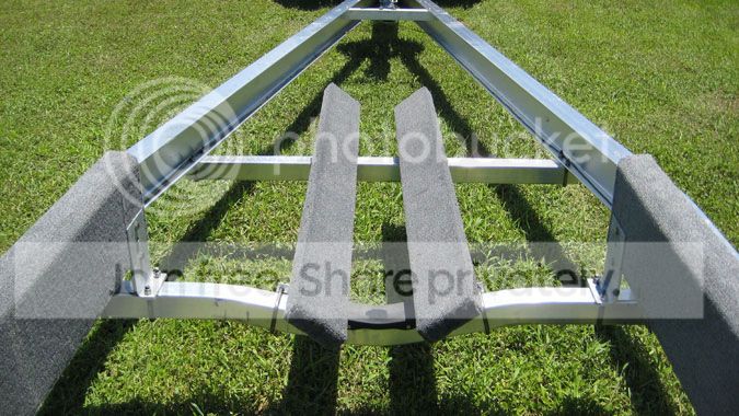

Perhaps you are putting the trailer too deep in the water when you retrieve. Normally, I have my front V-bunks that surround/guide the keel of the boat...
...with about 8" of the front of them out of the water when retrieving. Then I crank the boat into position, and rarely have a centering issue.
Do you have these on your trailer? They are the most important part for keeping it centered when retrieving. The PVC poles just keep you from totally missing the trailer when driving on, which I almost never do.
